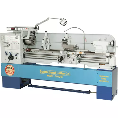

Features:
  • Two headstock gear speed ranges supply high torque in low range from 20 to 400 RPM and constant power from 400 to 2500 RPM in high range
  • Precision hardened and ground headstock gears run in an oil bath for super smooth, quiet and vibration free operation.
  • D1-6 camlock spindle has large 2-1/16" hole through spindle
  • The heavy-duty bed incorporates South Bend Lathe's signature 3 V-way and 1 flat way design, which assures precision alignment of the headstock, tailstock and saddle
  • The ways are induction hardened and precision ground to perfection
  • Meehanite bed castings.
  • Two T-slots are machined into the rear of the cross slide for mounting tooling or fixtures
  • Removable chip tray for ease of clean-up.
  • Top quality Japanese NSK bearings.
  • One shot lubrication in carriage.
  • 6" Tailstock barrel travel.
  • Variable-speed controlled by simple dial.
  • Digital spindle speed indicator.
  • Yaskawa frequency drive.
  • Tailstock with inch/metric graduated quill and tang knock-out slot
  • Centralized lubrication pump for bed-ways and cross slide
  • Quick action full length emergency foot brake
  • Dual-reading inch/metric dials on the cross feed and compound
  • Full length, rear mounted splash guard
  • Lockable main disconnect switch
  • Swing over bed: 16.14"
  • Distance between centers: 60"
  • Swing over cross slide: 10.375"
  • Swing over gap: 22.95"
  • Cross slide travel: 9.25"
  • Compound slide travel: 5.1"
  • Spindle nose: D1-6 Camlock
  • Spindle bore: 2.0625"
  • Taper inside spindle: MT#6
  • Spindle speed: Variable from 20 to 2500 RPM
  • RPM ranges: 20 to 400, 400 to 2500
  • Inch threads: (45) 2 to 72 TPI
  • Metric threads: (39) 0.2 to 14mm
  • Modular threads: (18) 0.3 to 3.5
  • Diametral threads: (21) 8 to 44
  • Longitudinal feed: 0.002 to 0.067 IPR
  • Cross feed: 0.001 to 0.034 IPR
  • Number of feed selections: 17
  • Tailstock barrel diameter: 2.047"
  • Tailstock quill travel: 6"
  • Tailstock taper: MT#4
  • Spindle motor: 7.5 HP
  • Voltage: 440V, 3-phase
  • Coolant motor: 1/8 HP
  • Footprint: 19-1/2" x 101-7/8"
  • Approximate shipping weight: 3652 lbs.
Standard Equipment:
  • 9" 3-Jaw scroll chuck
  • 10" 4-Jaw independent chuck
  • 12" faceplate
  • Steady rest
  • Follow rest
  • 4 way tool post
  • Halogen lamp
  • Complete coolant system
  • Turret micrometer stop
  • Two Morse taper dead centers
  • Single saddle stop
  • Thread dial indicator
  • Leveling bolts
  • USA written parts/instruction manual
  • Tool box & tool kit
Optional Equipment:
  • SB1269 Taper Attachment
  • SB1268 Collet Attachment
  • Attachment for 5-C Collets
