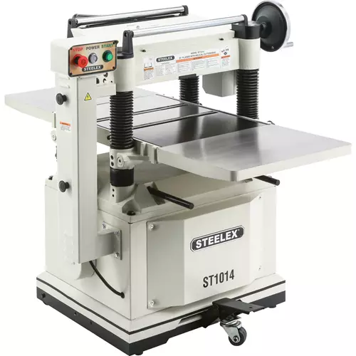

Image for Steelex ST1014 - 20" Planer with Helical-Style Cutterhead
With its built-in locking mobile base and pedestal-mounted switch, this 20" Helical Cutterhead Planer is easy to move and operate. Just press down on the lever with your foot to release the lock, and this planer is mobile. Features an extra-long 55-5/8" precision-ground cast-iron table, two feed speeds, board return rollers, a 20" x 8" capacity, adjustable bed rollers, magnetic switch with thermal-overload protection, and a 5 HP motor.
Certified to CSA & UL standards
  • Motor: 5 HP, 240V, single-phase, 19A
  • Maximum stock width: 20"
  • Maximum stock thickness: 8"
  • Minimum stock thickness: 3/16"
  • Minimum stock length: 8"
  • Maximum cut depth: 1/8"
  • Cutterhead diameter: 3-1/8"
  • Cutterhead type: 5-row helical with 100 inserts
  • Insert size & type: 15 x 15 x 2.5mm, indexable carbide
  • Cutterhead speed: 4800 RPM
  • Feed rate: 16 & 20 FPM
  • Table size with extensions: 15" x 42"
  • Dust port size: 5"
  • Footprint: 23-1/2" x 23-1/2"
  • Overall dimensions: 55-1/2" W x 43-1/2" D x 46" H
  • Approx. shipping weight: 874 lbs.
  • Built-in, easy-to-use mobile base
  • Chip breaker & pressure bar
  • Precision-ground cast-iron extension wings
  • Pedestal-mounted control switch
  • Inch and metric elevation scale
  • Two adjustable bed rollers
  • Board return rollers
  • Four-column support with positive table locks
  • Two-speed automatic board feed
