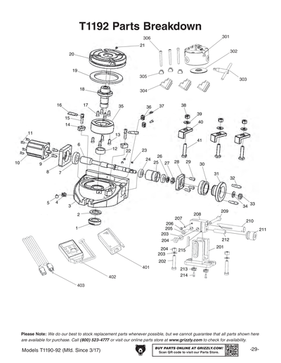

Parts for T1192 4-3/8" Power DRO Rotary Table Set
Parts Diagrams for T1192 - 4-3/8" Power DRO Rotary Table Set

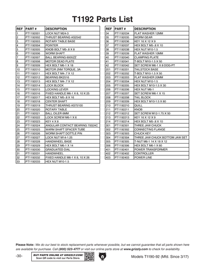

Parts List for Parts for T1192 4-3/8" Power DRO Rotary Table Set
LOCK NUT M24-3
THRUST BEARING AS2542
ROTARY TABLE BASE
POINTER
KNOB BOLT M5-.8 X 8
WORM SHAFT
BALL BEARING 6005ZZ
MOTOR DEAD PLATE
Now: PB91M
HEX BOLT M6-1 X 18
MOTOR 2NM TORQUE, 3A
Now: PB97M
HEX BOLT M4-.7 X 12
BEARING BK2516
Now: PB97M
HEX BOLT M4-.7 X 12
LOCK BLOCK
LOCKING LEVER
LOCKING LEVER HANDLE M6-1 X 8
Now: PB95M
HEX BOLT M5-.8 X 16
CENTER SHAFT
THRUST BEARING AS75100
ROTARY TABLE
BALL OILER 6MM
LOCK SCREW M6-1 X 6
KEY 4 X 8
ANGULAR CONTACT BEARING 7002AC
WARM SHAFT SPACER TUBE
WORM SHAFT DOTTLE PIN
LOCK NUT M14-1.25
HANDWHEEL BASE
HEX BOLT M6-1 X 14
GRADUATED DIAL
HANDWHEEL
FIXED HANDLE M6-1 X 8, 10 X 26
Now: PN02M
HEX NUT M10-1.5
Now: PW06M
FLAT WASHER 12MM
WORM GEAR
KEY 16 X 12 X 9
Now: PB96M
HEX BOLT M5-.8 X 10
Now: PN02M
HEX NUT M10-1.5
Now: PW04M
FLAT WASHER 10MM
CLAMPING PLATE
Now: PB73M
HEX BOLT M10-1.5 X 50
SET SCREW M6-1 X 8 DOG-PT
201
TAILSTOCK BASE
202
T-BOLT M10-1.5 X 50
203
Now: PW13M
FLAT WASHER 20MM
204
Now: PN02M
HEX NUT M10-1.5
205
Now: PB01M
HEX BOLT M10-1.5 X 30
206
Now: PN01M
HEX NUT M6-1
207
SET SCREW M6-1 X 15
208
TAIL BLOCK
209
Now: PB13M
HEX BOLT M10-1.5 X 80
210
QUILL
211
KNOB
212
SET SCREW M12-1.75 X 50
213
KEY 16 X 12 X 9
214
Now: PB96M
HEX BOLT M5-.8 X 10
301
THREE JAW CHUCK
302
CONNECTING FLANGE
303
CHUCK KEY
304
THREE JAW CHUCK BOTTOM JAW SET
305
T-NUT M6-1 14 X 18 X 12
306
HEX BOLT M6-1 X 60
401
POWER TRANSFORMER
402
CONTROLLER
403
POWER CORD
