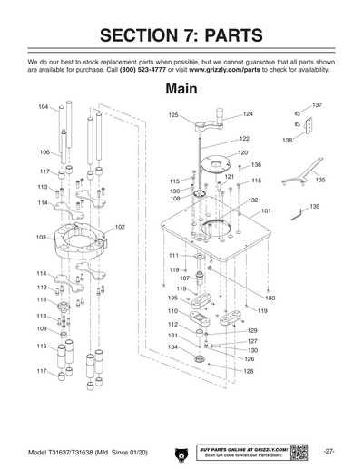

100
ROUTER LIFT ASSEMBLY
MOUNTING PLATE 11-3/4" X 9-1/4" V1

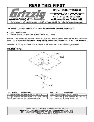

101V2
MOUNTING PLATE 11-3/4" X 9-1/4" V2.04.22
CLAMP BLOCK
SLIDE BLOCK
CLAMP GUIDE
CLAMP GUIDE MOUNT
106
LEADSCREW M14-1.5 X 135
107
LEADSCREW CONNECTOR
108
INDEX RING
109
Now: PN32M
HEX NUT M14-2
110
LEADSCREW MOUNT
111
COPPER PLATE
112
BUSHING 20 X 24 X 12 (COPPER)
113
CAP SCREW 1/4-20 X 3/4
114
ROUTER CLAMP PLATE
115
Now: PFH41
FLAT HD CAP SCR 1/4-20 X 1/2
116
GUIDE TUBE (ALUMINUM)
117
BUSHING 16 X 20 X 20 (COPPER)
118
LEADSCREW PILOT NUT M14-1.5
119
SET SCREW M6-1 X 6
120
INSERT 1-1/4"
121
STARTING PIN
122
HEX SHAFT 5 X 175
124
FIXED HANDLE 22 X 77, M10-1.5 X 14
125
CRANK M10-1.5, 95L
126
ROCKER ARM MOUNT 1/4-20 X 1/2
127
ROCKER ARM
128
SET SCREW M4-.7 X 5
129
Now: PN05
HEX NUT 1/4-20
130
CAP SCREW M3-.5 X 16
131
LOCK NUT M3-.5
132
CAP SCREW 1/4-20 X 1-1/4
132V2
CAP SCREW M6-1 X 30
133
Now: PLN02
LOCK NUT 1/4-20
133V2
Now: PN01M
HEX NUT M6-1
134
BRAKE DISC
135
SPANNER WRENCH 70MM PIN-TYPE
136
CAP SCREW M4-.7 X 16
137
Now: PFB01
FLANGE BOLT 5/16-18 X 1/2
138
ROUTER LIFT CRANK HOLDER
139
HEX WRENCH 3MM
140
THREADED ADJUSTMENT BRACKET
141
Now: PS07M
PHLP HD SCR M4-.7 X 8
MAN
MANUAL T31637/T31638 MFD-01.20+ V1.02.20
