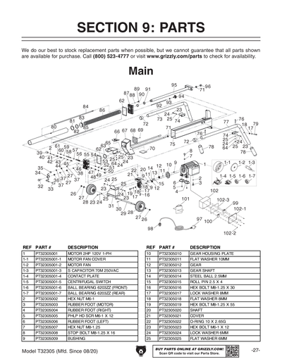

Parts for T32305 Electric Log Splitter With Wide Wheel
Parts Diagrams for T32305 - Electric Log Splitter With Wide Wheel
Parts List for Parts for T32305 Electric Log Splitter With Wide Wheel

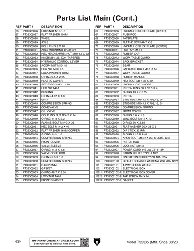

MOTOR 2HP 120V 1-PH
1-1
MOTOR FAN COVER
1-2
MOTOR FAN
1-3
S CAPACITOR 70M 250VAC
1-6
BALL BEARING 6203ZZ
1-7
BALL BEARING 6203ZZ
Now: PN01M
HEX NUT M6-1
RUBBER FOOT (MOTOR)
RUBBER FOOT (RIGHT)
Now: PS14M
PHLP HD SCR M6-1 X 12
RUBBER FOOT (RIGHT)
Now: PN03M
HEX NUT M8-1.25
STOP BOLT M8-1.25 X 16
BUSHING
GEAR HOUSING PLATE
Now: PW04M
FLAT WASHER 10MM
GEAR
GEAR SHAFT
STEEL BALL 2.5MM
ROLL PIN 2.5 X 4
Now: PB26M
HEX BOLT M8-1.25 X 30
LOCK WASHER 8MM
Now: PW01M
FLAT WASHER 8MM
Now: PB30M
HEX BOLT M8-1.25 X 55
SHAFT
COVER
O-RING 10 X 2.65G
Now: PB02M
HEX BOLT M6-1 X 12
LOCK WASHER 6MM
Now: PW03M
FLAT WASHER 6MM
LOCK NUT M10-1.5
Now: PW04M
FLAT WASHER 10MM
WHEEL
$41.75
AXLE
$5.10
ROLL PIN 3.2 X 20
AXLE MOUNTING BRACKET
HEX HEAD BARREL NUT M10-1.5 X 32
KNOB M8-1.25, D20, TAPERED
HYDRAULIC CONTROL LEVER
Now: PN43M
ACORN NUT M10-1.5
Now: PN02M
HEX NUT M10-1.5
LOCK WASHER 10MM
O-RING 9.5 X 2.65
PLASTIC COVER
SET SCREW M6-1 X 20
Now: PN01M
HEX NUT M6-1
BUSHING
O-RING 4.87 X 1.8
SHAFT
45
COMPRESSION SPRING
46
CONE VALVE
OIL VALVE
48
COUPLING NUT M14-2 X 14
49
O-RING 11.8 X 2.2
50
FLANGE BOLT M14-2 X 36
51
HEX BOLT M14-2 X 40
52
FLAT WASHER 16MM COPPER
53
O-RING 14 X 1.8
54
COMPRESSION SPRING
55
FRONT COVER
56
VALVE SLEEVE
57
O-RING 11.2 X 1.8
58
VALVE CORE ROD
59
O-RING 5.6 X 1.8
60
COMPRESSION SPRING
61
E-CLIP 8MM
62
GASKET
63
O-RING 48.7 X 3.55
64
LOCK NUT M6-1
65
FRONT BRACKET
66
HYDRAULIC SLIDE PLATE (UPPER)
67
PUSH ROD
68
FACEPLATE
69
FLAT HD SCR M4-.7 X 6
70
HYDRAULIC SLIDE PLATE (LOWER)
71
Now: PN32M
HEX NUT M14-2
72
RUBBER CAP
$1.90
73
WORK TABLE GUARD
74
BACK BRACKET
75
BEAM
76
CARRIAGE BOLT M6-1 X 50
77
WORK TABLE GUARD
78
RUBBER HANDLE
$2.05
79
Now: PB22M
HEX BOLT M8-1.25 X 50
80
HYDRAULIC CYLINDER
81
PISTON RING 58 X 52.5 X 4
82
O-RING 43.7 x 3.55
$1.49
83
PISTON
84
STUD-UDE M10-1.5 X 793,16, 28
85
86
COMPRESSION SPRING
87
FRONT COVER
88
O-RING 3.6 X 1.8
89
WING BOLT M4-.7 X 12
90
O-RING 30 X 2.65
91
FLAT WASHER 30 X 38 X 5
92
DIP STICK 321MM
93
O-RING 11.8 X 2.65
94
KNOB BOLT M14-2 X 20, 6-LOBE, D42
95
PISTON ROD
96
LOCK NUT M14-2
97
POWER CORD 14G 3W 72" 5-15P
98
STRAIN RELIEF TYPE-1 M20
99
ON BUTTON KEDU HY57B 18A 125V
100
CIRCUIT BREAKER WOKEMA W66 20A 125V
***SEE EXT. DESCRIPTION***
ELECTRICAL BOX
102-1
ELECTRICAL BOX COVER
102-2
TAP SCREW M4 X 14
102-3
GASKET
201
FLUID CAPACITY LABEL
202
MACHINE ID LABEL
203
COMBO WARNING LABEL
204
GLOSSY BLACK
205
ELECTRICITY 0.7W X 0.6H
206
STOP OIL FILL TAG 4W X 4H
207
AMPUTATION HAZARD LABEL
MAN
MANUAL T32305 MFD-08.20+ V1.09.20
