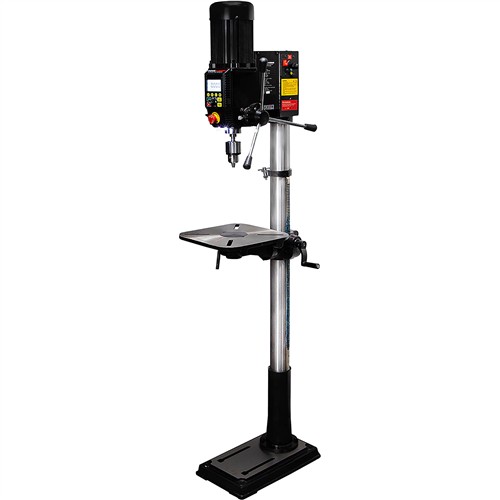

A groundbreaking redesign on a floor model drill press.
The T32590 Nova Viking 16" Floor Model Drill Press features a 1 HP DVR Smart Digital Motor delivers correct speed and power to maintain optimal torque direct to the drill head across the entire speed range.
The DVR technology brings unprecedented functionality and power to this drill press, with unrivaled torque and smoothness in this category. This makes it the perfect choice for projects like hole drilling, mortising and high-speed sanding.
The electronic variable speed varies between 150 - 3000 RPM (programmable to 5000 RPM).
The large easy-to-read digital readout allows you to choose between metric or imperial (decimals or fractions) and is easy to switch between modes.
The built in LED lights and laser location makes it easy to see clearly and locate your center.
Add to all of this an electronic depth stop, solid cast-iron table and self-start to enable one-handed drilling, you can have a machine that just can't be beat!
  • Motor: 1 HP, 110V/220V, single-phase, 15A/7.5A
  • Swing: 16"
  • Spindle taper: MT#2
  • Spindle travel: 4-1/2"
  • Spindle speeds: Variable, 150 - 3000 RPM (programmable to 5000 RPM)
  • Drill chuck: 5/8"
  • Max. distance from spindle to table: 12-5/8"
  • Max. distance from spindle to base: 22-5/8"
  • Table swivel around column: 360°
  • Table dimensions: 12-19/32" x 12-19/32" (320mm x 320mm)
  • Base dimensions: 18.5" x 10-5/8" x 2-5/32" (468.7mm x 270mm x 55mm)
  • Machine weight: 200 lbs.
  • Shipping dimensions: 72" L x 21" W x 16" H
  • Easy-to-read digital display
  • Built-in laser and LED light to keep your project well-lit
  • Electronic depth stop for repeatable drilling
  • Self-start allows one-handed drilling
  • Solid cast-iron table
  • Direct-drive; no belts or pulleys to cause vibration or loss of power
  • Emergency-stop braking
  • 2-year full replacement warranty on motor and controller
  • 5-year full replacement warranty on all other parts
