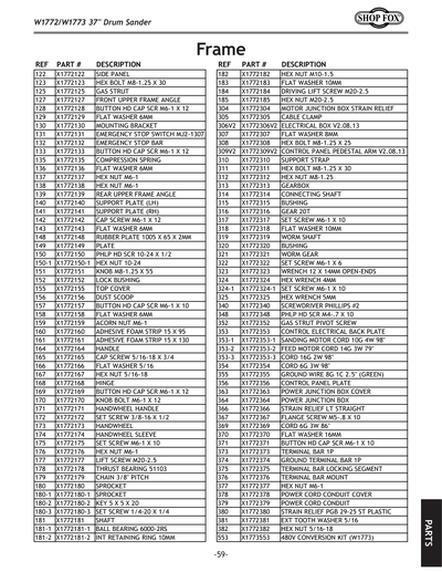

FRAME
$950.15
LIFTING EYE BOLT 1/2-13
ELEVATION SCALE
MOTOR MOUNT
106
Now: PB75M
HEX BOLT M12-1.75 X 35
107
Now: PN09M
HEX NUT M12-1.75
108
HEX BOLT M12-1.75 X 120
109
Now: PW06M
FLAT WASHER 12MM
110
Now: PN09M
HEX NUT M12-1.75
111
SANDING MOTOR 10HP 240V 1-PH
111-1
MOTOR FAN COVER
111-10
BALL BEARING 6206-2RS
111-11
CONTACT PLATE 2PC
$25.40
111-2
MOTOR FAN
111-3
R CAPACITOR 50M 350V 1-3/4 X 3-5/16
111-4
CAPACITOR COVER
111-5
MOTOR JUNCTION BOX
111-6
S CAPACITOR 300M 250V 1-3/4 X 3-3/4 ROHS
111-7
CONTACT PLATE 2PC
111-8
CENTRIFUGAL SWITCH
111-9
BALL BEARING 6308-2RS
112
KEY 7 X 7 X 35
113
HEX BOLT M10-1.5 X 45
114
Now: PW04M
FLAT WASHER 10MM
115
Now: PN02M
HEX NUT M10-1.5
116
SANDING MOTOR PULLEY
117
SET SCREW M8-1.25 X 10
117-1
SET SCREW M8-1.25 X 20
118
Now: PVB69
V-BELT B69
119
BELT COVER
120
KNOB BOLT M6-1 X 105
$3.55
121
Now: PW03M
FLAT WASHER 6MM
122
SIDE PANEL
123
Now: PB26M
HEX BOLT M8-1.25 X 30
124
BEVEL GEAR COVER (RH)
124A
BEVEL GEAR COVER (LH)
125
GAS STRUT
127
FRONT UPPER FRAME ANGLE
128
BUTTON HD CAP SCR M6-1 X 12
129
Now: PW03M
FLAT WASHER 6MM
130
MOUNTING BRACKET
131
EMERGENCY STOP SWITCH MJ2-1307 15A/250V
132
EMERGENCY STOP BAR
133
135
COMPRESSION SPRING
136
Now: PW03M
FLAT WASHER 6MM
137
Now: PN01M
HEX NUT M6-1
138
Now: PN01M
HEX NUT M6-1
139
REAR UPPER FRAME ANGLE
140
SUPPORT PLATE (LH)
141
SUPPORT PLATE (RH)
142
CAP SCREW M6-1 X 12
143
Now: PW03M
FLAT WASHER 6MM
148
RUBBER PLATE 1005 X 65 X 2MM
149
PLATE
150
Now: PS01
PHLP HD SCR 10-24 X 1/2
150-1
Now: PN07
HEX NUT 10-24
151
KNOB M8-1.25 X 55
152
LOCK BUSHING
155
TOP COVER
156
FRONT DUST SCOOP
157
BUTTON HD CAP SCR M6-1 X 10
158
Now: PW03M
FLAT WASHER 6MM
159
Now: PN35M
ACORN NUT M6-1
160
ADHESIVE FOAM STRIP 15 X 95
161
ADHESIVE FOAM STRIP 15 X 130
164
HANDLE
165
CAP SCREW 5/16-18 X 3/4
166
Now: PW07
FLAT WASHER 5/16
167
Now: PN02
HEX NUT 5/16-18
168
HINGE
169
170
KNOB BOLT M6-1 X 12
171
HANDLE V1.12.95
172
Now: PSS09
SET SCREW 3/8-16 X 1/2
173
HANDWHEEL
174
HANDWHEEL SLEEVE
175
SET SCREW M6-1 X 10
176
Now: PN01M
HEX NUT M6-1
177
LIFT SCREW M20-2.5
178
THRUST BEARING 51103
179
CHAIN 3/8" PITCH
180
SPROCKET
180-1
SPROCKET
180-2
Now: PK34M
KEY 5 X 5 X 20
180-3
Now: PSS11
SET SCREW 1/4-20 X 1/4
181
SHAFT
181-1
BALL BEARING 6000-2RS
181-2
Now: PR45M
INT RETAINING RING 10MM
182
Now: PN02M
HEX NUT M10-1.5
183
Now: PW04M
FLAT WASHER 10MM
184
DRIVING LIFT SCREW M20-2.5
185
Now: PN28M
HEX NUT M20-2.5
186
TABLE
187
TABLE SUPPORT (FL, RR)
188
TABLE SUPPORT (FR, RL)
189
Now: PB26M
190
LOCK WASHER 8MM
191
OUTFEED ROLLER SUPPORT BRACKET (LH)
192
OUTFEED ROLLER SUPPORT BRACKET (RH)
193
Now: PB26M
194
LOCK WASHER 8MM
195
HEX BOLT M12-1.75 X 80
196
Now: PN09M
HEX NUT M12-1.75
197
OUTFEED ROLLER
197-1
OUTFEED ROLLER SHAFT
198
BALL BEARING 6204-2RS
199
LOCK COLLAR
200
SET SCREW M6-1 X 10
201
OUTFEED ROLLER COVER (LH)
202
OUTFEED ROLLER COVER (RH)
203
204
Now: PW03M
FLAT WASHER 6MM
205
CONVEYOR BELT 930 X 2290MM
206
INFEED ROLLER SUPPORT BRACKET (LH)
207
POINTER
208
Now: PS09M
PHLP HD SCR M5-.8 X 10
209
Now: PB26M
210
INFEED ROLLER
211
Now: PK34M
KEY 5 X 5 X 20
212
FLANGE BEARING UCFL204
213
Now: PB32M
HEX BOLT M10-1.5 X 25
214
Now: PW04M
FLAT WASHER 10MM
215
INFEED ROLLER SUPPORT BRACKET (RH)
216
Now: PB26M
217
GROMMET 15 X 19MM
219
ROLLER SPROCKET
220
221
CHAIN 3/8
222
MOTOR SPROCKET
223
Now: PK15M
KEY 5 X 5 X 35
224
225
SPEED REDUCER HOUSING
225-1
OIL FILL PLUG 5/8-18
225-2
Now: PS55M
PHLP HD SCR M3-.5 X 10
226
Now: PW01M
FLAT WASHER 8MM
227
Now: PB15M
HEX BOLT M8-1.25 X 40
228
Now: PN03M
HEX NUT M8-1.25
229
GEARBOX SHAFT SLEEVE
230
231
Now: PK17M
KEY 5 X 5 X 80
232
Now: PR37M
EXT RETAINING RING 32MM
233
COLLAR
234
COMPRESSION SPRING
235
GEARBOX INSIDE PULLEY HALF
236
Now: PVA25
V-BELT A25
237
GEARBOX OUTSIDE PULLEY HALF
238
FEED MOTOR 1/3HP 240V 1-PH
238-1
MOTOR FAN COVER
238-10
BALL BEARING 6203-2RS
238-11
BALL BEARING 6202-2RS
238-2
MOTOR FAN
238-3
CAPACITOR COVER
238-4
S CAPACITOR 75M 125V 1-3/8 X2-1/4
238-5
CAPACITOR COVER
238-6
R CAPACITOR 20M 300V 1-5/16 X 2
238-7
MOTOR JUNCTION BOX
238-8
CENTRIFUGAL PLATE
238-9
CONTACT PLATE
238A
MOTOR ASSY W/ PULLEYS
$342.10
239
Now: PB07M
HEX BOLT M8-1.25 X 25
240
Now: PW01M
FLAT WASHER 8MM
241
KEY 5 X 5 X 55
242
Now: PN03M
HEX NUT M8-1.25
243
MOTOR SHAFT SLEEVE
244
245
246
SET SCREW M6-1 X 10
247
BALL BEARING 608-2RS
248
SHAFT
249
Now: PB02M
HEX BOLT M6-1 X 12
250
LOCK WASHER 6MM
251
VS OUTSIDE PULLEY
252
Now: PR18M
EXT RETAINING RING 17MM
253
Now: G3850
Bearing - 35mm x 17mm
254
Now: PR12M
EXT RETAINING RING 35MM
255
PULLEY NUT 1/2-12
256
Now: PN02M
HEX NUT M10-1.5
257
KNURLED COLLAR
258
SET SCREW M6-1 X 10
259
HANDWHEEL
260
Now: PR45M
261
BAR WITH SLEEVE
262
BAR WITH SLEEVE
263
LOCK NUT M6-1
264
KNOB SUPPORT PLATE
269
270
CONVEYOR MOTOR COVER DOOR
271
$55.75

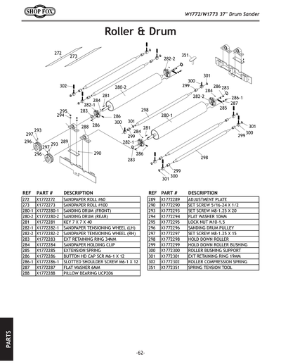

272
SANDING PAPER ROLLS #60
273
SANDING PAPER ROLLS #100
274
Now: PS19M
PHLP HD SCR M5-.8 X 6
277
INFEED GUARD
278
Now: PB02M
HEX BOLT M6-1 X 12
279
Now: PW03M
FLAT WASHER 6MM
280-1
SANDING DRUM, FRONT (STEEL)
280-2
SANDING DRUM, REAR (RUBBER)
281
Now: PK55M
KEY 7 X 7 X 40
282-1
SANDPAPER TENSIONING WHEEL (LH)
282-2
SANDPAPER TENSIONING WHEEL (RH)
283
Now: PR84M
EXT RETAINING RING 34MM
284
CLIP
285
EXTENSION SPRING
286
286-1
287
Now: PW03M
FLAT WASHER 6MM
288
PILLOW BEARING UCP206
$67.30
289
ADJUSTMENT PLATE
290
Now: PSS51
SET SCREW 5/16-24 X 1/2
293
294
Now: PW04M
FLAT WASHER 10MM
295
LOCK NUT M10-1.5
296
SANDING DRUM PULLEY
297
SET SCREW M8-1.25 X 15
298
HOLD DOWN ROLLER
299
HOLD DOWN ROLLER BUSHING
$7.00
300
ROLLER BUSHING SUPPORT
301
Now: PR08M
EXT RETAINING RING 19MM
302
ROLLER COMPRESSION SPRING
303
STRAIN RELIEF
$1.80
304
STRAIN RELIEF M25 TYPE-6 ST
305
CABLE CLAMP
306
ELECTRICAL BOX V1
$62.25
306V2
ELECTRICAL BOX V2.08.13
307
Now: PW01M
FLAT WASHER 8MM
308
Now: PB07M
309
CONTROL PANEL PEDESTAL ARM V1
$60.55
309V2
CONTROL PANEL PEDESTAL ARM V2.08.13
310
SUPPORT STRAP
311
Now: PB26M
312
Now: PN03M
HEX NUT M8-1.25
313
GEARBOX
314
CONNECTING SHAFT
315
BUSHING
316
GEAR 20T
317
SET SCREW M6-1 X 10
318
Now: PW04M
FLAT WASHER 10MM
319
WORM SHAFT
320
BUSHING
321
WORM GEAR
322
SET SCREW M6-1 X 6
323
WRENCH 12 X 14MM OPEN-ENDS
324
HEX WRENCH 4MM
324-1
SET SCREW M6-1 X 10
325
HEX WRENCH 5MM
340
Now: PSDP2
SCREWDRIVER PHILLIPS #2
348
Now: PS38M
PHLP HD SCR M4-.7 X 10
351
SPRING TENSION TOOL
351-1
Now: PN06M
HEX NUT M5-.8
351-2
CAP SCREW M5-.8 X 15
352
GAS STRUT PIVOT SCREW
353
ELECTRICAL PANEL 240V
353-1
SANDING MOTOR CORD 10G 4W 98"
353-2
FEED MOTOR CORD 14G 3W 79"
353-3
CORD 16G 2W 98"
354
CORD 6G 3W 98"
355
GROUND WIRE 8G 1C 2.5" (GREEN)
356
CONTROL PANEL PLATE
356-1
CONTROL PANEL ASSEMBLY BOX
$5.95
363
POWER JUNCTION BOX COVER
364
POWER JUNCTION BOX
366
GROMMET M11 TYPE-2 SNAP-IN
367
FLANGE SCREW M5-.8 X 10
369
CORD 6G 3W 86"
370
Now: PW08M
FLAT WASHER 16MM
371
373
TERMINAL BAR 1P
374
GROUND TERMINAL BAR 1P
375
TERMINAL BAR LOCKING SEGMENT
376
TERMINAL BAR MOUNT
377
Now: PN01M
HEX NUT M6-1
378
POWER CORD CONDUIT COVER
379
POWER CORD CONDUIT
380
STRAIN RELIEF PGB 29-25 ST PLASTIC
381
EXT TOOTH WASHER 5/16
382
Now: PN02
HEX NUT 5/16-18

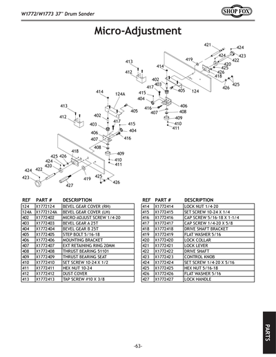

402
MICRO-ADJUST SCREW 1/4-20
403
BEVEL GEAR A 25T
404
BEVEL GEAR B 25T
405
STEP BOLT 5/16-18
406
MOUNTING BRACKET
407
Now: PR09M
EXT RETAINING RING 20MM
408
THRUST BEARING 51101
409
THRUST BEARING SEAT
410
Now: PSS34
SET SCREW 10-24 X 1/2
411
Now: PN07
HEX NUT 10-24
412
DUST COVER
413
TAP SCREW #10 X 3/8
414
Now: PLN02
LOCK NUT 1/4-20
415
Now: PSS29
SET SCREW 10-24 X 1/4
416
CAP SCREW 5/16-18 X 1-1/4
417
CAP SCREW 1/4-20 X 5/8
418
DRIVE SHAFT BRACKET
419
Now: PW07
FLAT WASHER 5/16
420
LOCK COLLAR
421
LOCK LEVER
422
DRIVE SHAFT
423
CONTROL KNOB
424
Now: PSS04
SET SCREW 1/4-20 X 5/16
425
Now: PN02
HEX NUT 5/16-18
426
Now: PW07
FLAT WASHER 5/16

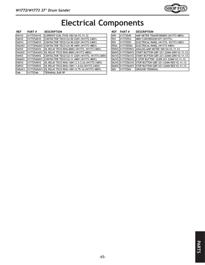

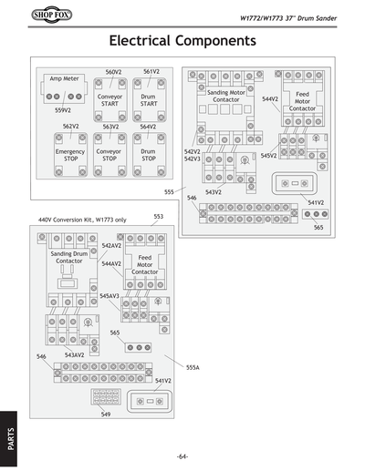

CURRENT COIL TH30 150/5A CT V1
$11.00
541V2
CURRENT COIL TH30 100/5A V2.11.12
542
CONTACTOR SDE MA-55 220V V1
542V2
CONTACTOR TECO CU-50R 220V V2.10.10
543
OL RELAY SDE RA-60 32-50A V1
543V2
OL RELAY TECO RHU-80K3 35-47A V2.10.10
544
CONTACTOR SDE MA-09 220V
544V2
CONTACTOR TECO CU-11 V2.10.10
545
OL RELAY SDE RA-20 2.7-4.4A V1
545V2
OL RELAY TECO RHU-10K 2.3-3.2A V2.10.10
546
TERMINAL BAR 10P
547
INCOMING POWER TERMINAL BLOCK
$7.35
549
AMP METER TRANSFORMER
$28.05
553
440V CONVERSION KIT
555
556
CONTROL PANEL PLATE
559
DIGITAL AMP METER V1
$148.65
559V2
AMP METER, ANALOG 100/5A V2.11.13
560
START BUTTON GBF-221 22MM GRN V2.11.13
560V2
561
DRUM START BUTTON 22MM GRN V1
$22.60
561V2
562
E-STOP BUTTON 22MM V1
562V2
E-STOP BUTTON GLEB-221 22MM V2.11.13
563
CONVEYOR STOP BUTTON 22MM RED V1
563V2
STOP BUTTON GBF-221 22MM RED V2.11.13
564
DRUM STOP BUTTON 22MM RED V1
$8.95
564V2
565
GROUND TERMINAL
566

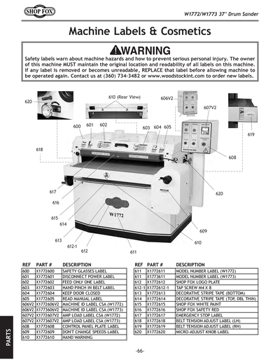

601
DISCONNECT POWER LABEL
$0.95
602
FEED ONLY ONE LABEL
$0.95
603
HAND PINCH IN BELT LABEL
$0.95
604
KEEP DOOR CLOSED
$1.60
605
606
MACHINE ID LABEL NON-CSA V1
$16.40
606V2
MACHINE ID LABEL CSA V2.08.13
$16.40
607
AMP LOAD LABEL NON-CSA V1
$2.75
607V2
AMP LOAD LABEL CSA V2.08.13
$3.95
608
CONTROL PANEL PLATE LABEL
$7.25
609
DON'T CHANGE SPEEDS LABEL
610
HAND WARNING LABEL
611
MODEL NUMBER LABEL
$16.40
612
Now: D3377
Nameplate - Large
612-1
TAP SCREW M4 X 8
613
DECORATIVE STRIPE TAPE (BOTTOM)
$6.25
614
DECORATIVE STRIPE TAPE (TOP, DBL THIN)
$6.25
615
SHOP FOX WHITE M1006
616
RED REF TOOL BOXES
617
EMERGENCY STOP LABEL
618
BELT TENSION ADJUST LABEL (LH)
619
BELT TENSION ADJUST LABEL (RH)
620
MICRO-ADJUST KNOB LABEL
