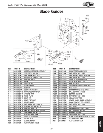

Parts for W1825 19" 3 HP Heavy Duty Bandsaw

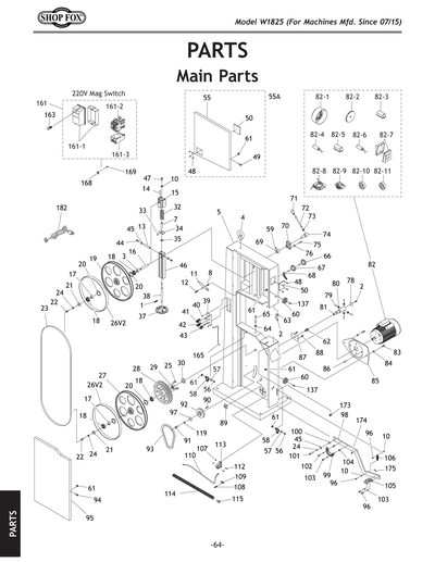

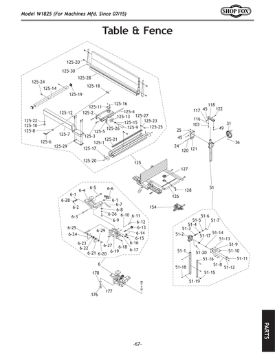

Parts Diagrams for W1825 - 19" 3 HP Heavy Duty Bandsaw

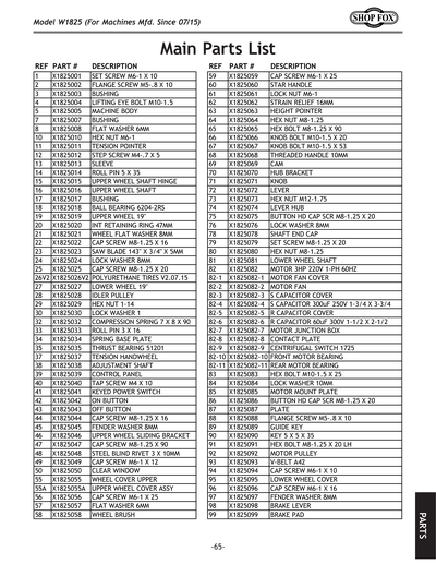

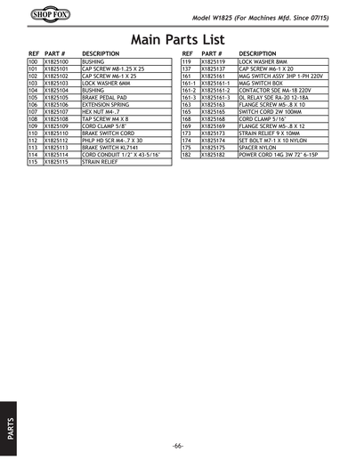

Parts List for Parts for W1825 19" 3 HP Heavy Duty Bandsaw

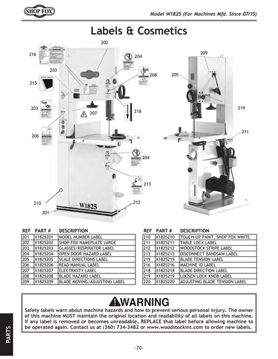

203
204
***USE PXLABEL-03***
$7.15
205
SCALE DIRECTIONS LABEL
206
207
ELECTRICITY 1.4W X 1.2H
208
BLADE HAZARD LABEL
$1.45
209
TENSION ADJ LABEL
210
SHOP FOX WHITE M1006
213
***USE PLABEL-63***
$7.15
215
BLADE TENSION LABEL
$4.50
216
MACHINE ID LABEL
$16.40
