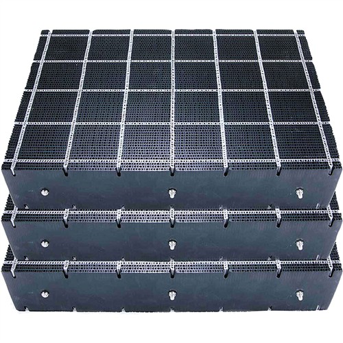

T34215 WAZER Waterjet Cut Bed 3-Pk.
Replace your WAZER cutting bed for optimal cutting.
Built for precise and durable cutting, the three replacement WAZER cut beds are 4 inches thick and crafted from finely corrugated polypropylene plastic. This material offers both flexibility and strength, ideal for absorbing the impact of waterjet cutting.
For extra durability and extended use, the top and bottom surfaces are heat-welded together, ensuring a consistently flat cutting surface. Plus, you can flip the bed over! Both sides are usable, maximizing their lifespan and value.
The cut bed is also oversized to allow for an additional fastening border. The grid pattern acts as a visual aid and reference indicator so you can easily adjust the placement of your material in your WAZER to match your file placement in the WAM software.
The WAZER cut bed can be easily replaced if the current one doesn't offer enough support or fastening points for your specific project. This ensures you have the right base for clean, precise cuts on any material you choose.
  • Material: Corrugated polypropylene sheets
  • Lifetime per cut bed: 20–100 hours. Highly dependent on geometry being cut.
  • Overall dimensions: 19" W x 13" L x 4" H each
  • Reversible–lifetime estimate assumes both sides are utilized
  • Top and bottom surfaces heat-welded for flatness
  • 3" x 3" Grid pattern acts as reference indicator matching WAZER WAM software
