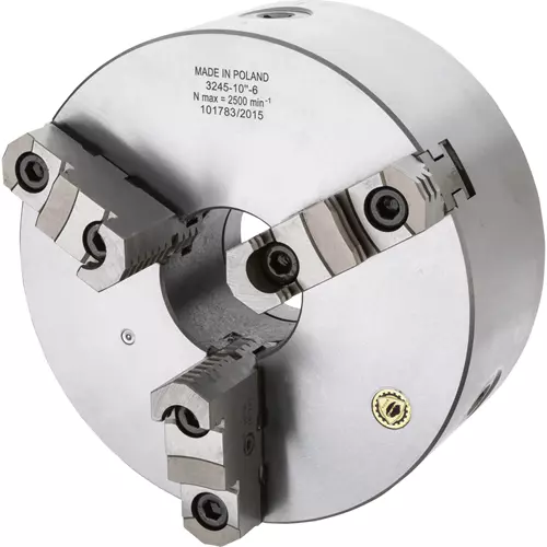

T10402 Bison 10" D1-6 3-Jaw Self-Centering Scroll Chuck
Bison lathe chucks deliver precision and accuracy you can count on, making them a trusted choice for professionals.
This D1-6 camlock 3-jaw chuck is made with a cast-iron body, 2-piece, hardened jaws, and come complete with a chuck wrench.
  • Chuck diameter: 10"
  • Mount: D1-6
  • Maximum speed: 2000 RPM
  • Jaw type: 2-Piece jaws
  • Jaw style: Hard 2-piece jaws
  • Number of jaws: 3
  • Bolt quantity: 6
  • Camlock stud diameter: 7/8"
  • Precision class: Standard accuracy chuck
  • Body material: Cast iron
  • Clamping range d1 (min-max): 0.197"–4.65"
  • Clamping range d2 (min-max): 3.39"–7.76"
  • Clamping range d3 (min-max): 6.30"–9.84"
  • Clamping range d4 (min-max): 2.28"–6.50"
  • Clamping range d5 (min-max): 4.92"–9.25
  • Approximate shipping weight: 43 lbs.
