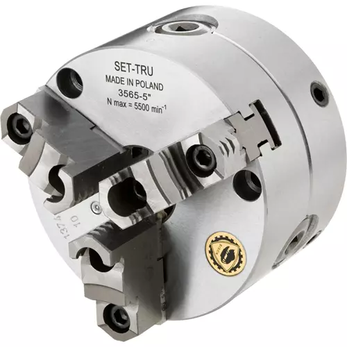

T10417 Bison 5" Plain Back 3-Jaw Self-Centering SET-TRU Scroll Chuck
Bison lathe chucks deliver precision and accuracy you can count on, making them a trusted choice for professionals.
This is a 5" self-centering chuck with fine adjustment offering 0.0004" concentricity. The plain back mounted 3-jaw chuck has forged steel bodies for durability and 2-piece, hardened jaws.
  • Chuck diameter: 5"
  • Mount: Plain back
  • Maximum speed: 5500 RPM
  • Jaw type: 2-Piece jaws
  • Jaw style: Hard 2-piece jaws
  • Number of jaws: 3
  • M bolt thread: M8x1.25
  • M bolt quantity: 3
  • N bolt thread: M10x1
  • N bolt quantity: 4
  • Precision class: Precision Chuck with Fine Adjustment
  • Body material: Steel
  • Hole diameter D: 1.378"
  • F: 4.252"
  • E: 2.1654"
  • H: 2.362"
  • h: 1.575"
  • C: 0.59"
  • Clamping range d1 (min-max): 0.118"–1.97"
  • Clamping range d2 (min-max): 2.05"–3.78"
  • Clamping range d3 (min-max): 3.74"–4.92"
  • Clamping range d4 (min-max): 1.34"–2.99"
  • Clamping range d5 (min-max): 2.95"–4.65
  • Approximate shipping weight: 15 lbs.
