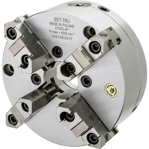

T10423 Bison 8" 4-Jaw Self-Centering SET-TRU Chuck
We are proud to offer Bison Lathe chucks.
Bison lathe chucks deliver precision and accuracy you can count on, making them a trusted choice for professionals.
This is an 8" self-centering chuck with fine adjustment offering 0.0004" concentricity. The plain back mounted 4-jaw chuck has forged steel bodies for durability and 2-piece, hardened jaws.
This chuck requires a backplate for installation.
  • Chuck diameter: 8"
  • Mount: Plain back
  • Maximum speed: 4000 RPM
  • Jaw type: 2-Piece jaws
  • Jaw style: Hard 2-piece jaws
  • Number of jaws: 3
  • M bolt thread: M10x1.5
  • M bolt quantity: 3
  • N bolt thread: M18x1
  • N bolt quantity: 4
  • Precision class: Precision Chuck with Fine Adjustment
  • Body material: Steel
  • Hole diameter D: 2.165"
  • F: 6.9291"
  • E: 4.3307"
  • H: 3.071"
  • h: 1.77"
  • C: 0.71"
  • Clamping range d1 (min-max): 0.157"–3.54"
  • Clamping range d2 (min-max): 2.83"–6.14"
  • Clamping range d3 (min-max): 5.24"–7.87"
  • Clamping range d4 (min-max): 1.97"–5.12"
  • Clamping range d5 (min-max): 4.13"–7.48
  • Approximate shipping weight: 40 lbs.
