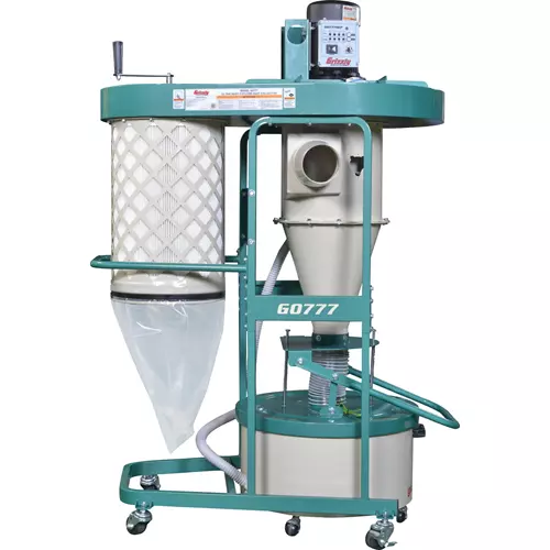

G0777 1-1/2 HP Ultra-Quiet Cyclone Dust Collector
A high quality and quiet cyclone dust collector.
The G0777 1-1/2 HP Ultra-Quiet Cyclone Dust Collector is truly that; ultra-quiet. Most two-stage dust collectors this size operate over 80 dB. The G0777 can collect even the biggest shavings without exceeding 72 dB.
It runs quieter than a household vacuum due to its slow-speed motor and 24" cast-aluminum impeller. An impressive 880 CFM airflow creates a vortex of incoming air that extracts heavy wood chips and large dust particles into a plastic-bag-lined 26-gallon drum.
The remaining fine dust is caught by a pleated canister filter and deposited in a separate plastic collection bag. The spun-bond polyester filter catches 99.9% of particles to 0.2-2 micron in size and is pleated to provide maximum surface area for efficient air flow.
A turn of the crank handle rotates the paddle brushes, knocking caked-on dust off of the pleats into a plastic collection bag and keeps your CFM as high as possible.
A remote-control receiver and remote controller allow the dust collector to be turned on and off from up to 75 feet away.
The upgraded T10878 HEPA Filter Kit is also available for those wanting to capture particles down to 0.3 microns.
Like all Grizzly cyclones, the G0777 comes with a 1-year warranty which covers parts and assures the unit is free from factory defects.
The G0777 manual was written by our U.S. based Technical Documentation Department and is packed with useful information.
The Grizzly Customer Service and Technical Support Teams are U.S. based. Parts and accessories for your machine may be available online and shipped from the Grizzly parts warehouse in Springfield, MO.
