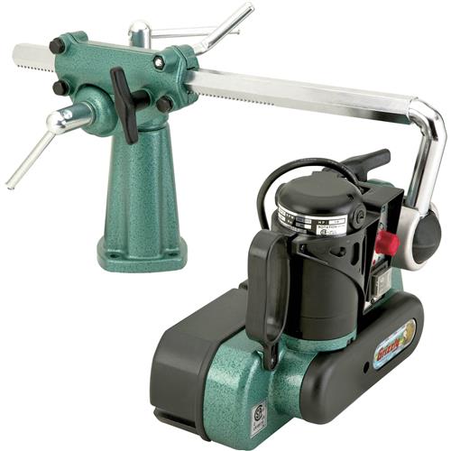

G4173 1/8 HP Variable-Speed 3-Roller Power Feeder, Single-Phase
Increase your lumber feeding efficiency.
If you do any kind of production ripping or milling, you know what a big chore it can be feeding by hand, especially with longer and wider stock.
For those who want to increase production, upgrade or add on another stock feeder, we have the G4173 to help you along without crushing your budget.
The 1/8 HP motor powers three synthetic rubber rollers that measure 1-3/16" wide by 3" in diameter.
  • Motor: 1/8 HP, 120V, single-phase, 1.2A
  • Feed speed: Variable, 6.5–39 FPM
  • Rotation: Forward/reverse
  • Maximum height of rollers: 6"
  • Minimum workpiece length: 5"
  • Horizontal travel: 10-1/4"
  • Swing: 360°
  • Rollers: (3) synthetic rubber, 1-3/16" wide x 3" dia.
  • Roller suspension: 5/16"
  • Approximate shipping weight: 27 lbs.
  • Forward/reverse feed
  • Variable feed speed
  • X-, Y-, and Z-axis adjustment
  • Rollers are spring-tensioned
  • Heavy-duty gear reduction with hardened gears
  • Universal positioning with handle locks
We offer U.S.-based customer service and technical support to get your questions answered and help keep your equipment running in top condition. And to ensure your satisfaction, the G4173 comes with a 1-year warranty.
