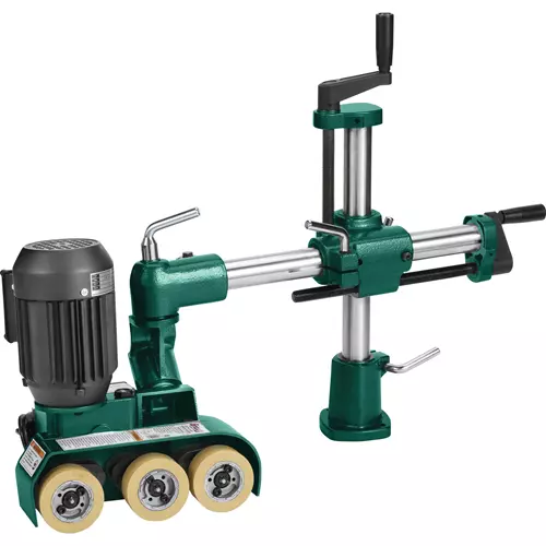

G4176 1/4 HP 4-Speed 3-Roller Power Feeder, Single-Phase
Production ripping or milling can become a chore feeding by hand.
The G4176 1/4 HP Power Feeder is for those who want to increase production, upgrade, or add on another stock feeder.
The G4176 has the option to feed a workpiece at six different feed rates: 20, 23, 33, and 43 feet per minute.
The G4177 Replacement Roller and H3236 Slow Speed Kit are available. The H3236 increases the speed range allowing for both slower and faster feed rates.
  • Motor: 1/4 HP, 120V, single-phase, 2.5A
  • Feed speeds: 20, 26, 33, 43 FPM
  • Rotation: Forward and reverse
  • Maximum height of rollers: 6"
  • Minimum workpiece length: 5"
  • Vertical travel: 6-1/2"
  • Horizontal travel: 10"
  • Swing: 360°
  • Rollers: (3) synthetic rubber, 1-3/16" wide x 3-1/8" dia.
  • Roller suspension: 3/4"
  • Overall dimensions: 34" W x 13" D x 24" H
  • Approximate shipping weight: 79 lbs.
  • Forward/reverse feed
  • Multiple feed speeds
  • X-, Y-, Z-axis adjustment
  • Rollers are spring tensioned
  • Heavy-duty gear reduction with hardened gears
  • Universal positioning with handle locks
We offer U.S.-based customer service and technical support to get your questions answered and help keep your equipment running in top condition. And to ensure your satisfaction, the G4176 comes with a 1-year warranty.
CSA certified
