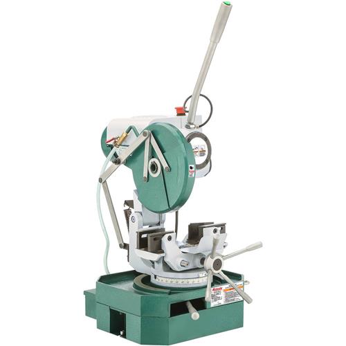

T28366 10" Slow-Speed Cold-Cut Metal-Cutting Saw
A high-quality manual cold cut saw that doesn't scrimp on cutting capacity!
The T28366 10" Slow Speed Cold Cut Saw features a rugged oil-bath gear-drive power transfer and quick angle adjustment controls.
The head and column rotate 90° left or right of center for precise angled cuts. The miter scale shows the angle of the blade, and the miter lock lever secures the angle for repeated cuts.
It features a self-centering vise that provides maximum support, while still providing enough clearance for cutting at a variety of angles.
Each vise jaw is independently adjustable left or right to provide proper support and blade clearance for the cut.
The built-in coolant system helps extend the life of your blades by preventing them from overheating, especially when cutting metal.
Please note: Blade is not included with saw and must be purchased separately.
An optional stand is available for a permanent workstation.
  • Main motor: 1 HP, 115V, single-phase, 8.5A
  • Coolant pump: 15W, 0.14A
  • Blade speed: 68 RPM
  • Blade size: 10"
  • Blade arbor: 32mm dia.
  • Blade pinhole pattern: 2 holes, 8.5mm dia., 45mm OC
  • Max capacity round: 2-1/2" @ 90°, 2-1/8" @ 45°
  • Max capacity square: 2-3/8" x 2-3/8" @ 90°, 2" x 2" @ 45°
  • Vise jaw max opening: 4-1/2"
  • Vise jaw height: 2"
  • Head swivel: 45° left and right
  • Footprint: 16" x 16"
  • Overall dimensions: 18-1/2" W x 27" D x 38" H
  • Approximate shipping weight: 176 lbs.
  • Cuts metal
  • Coolant system with flow control valve
  • Gear-driven blade for low-RPM cutting
  • Built-in coolant system with flow control valve
  • Quick-release handle for fast miter cut adjustments
  • Dual-clamping vise action for fast clamping
  • Four individually adjustable clamping jaws on vise for safe and secure workpiece control
  • Push-button start control on handle
