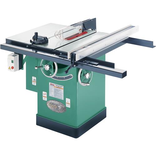

Built with the same heavy steel cabinet and cast iron table as the extremely popular Model G1023S, this left-tilting saw became an instant hit when introduced last year. Just as with the G1023S, the motor is 3 H.P., single-phase, 220V and has a triple-belt pulley. The blade splitter has been redesigned from that of the G1023S for even easier adjustments, and the accurate and dependable Shop Fox® Classic fence also comes as standard equipment.
Features:
  • 3 H.P. single-phase, 220V motor
  • Solid cast iron table is first heat treated to remove warpage, then milled perfectly flat and ground to a mirror-like finish
  • Table has T-slots so your miter gauge will not fall off the table when retracted
  • Table size (with 2 solid extension wings attached) is 40-1/8" x 27"
  • Extra-large handwheels are the heaviest in the industry and really ease arbor movement
  • Cutting capacity: 8" left and 26" right of blade
  • Maximum depth of cut @ 90°: 3"
  • Maximum depth of cut @ 45°: 2-1/8"
  • 5/8" diameter arbor is long enough to accept dado blades up to 13/16"
  • One-piece steel cabinet-type stand
  • Magnetic safety switch is standard and protects the motor and operator
  • All sealed ball bearing construction
  • Triple V-belt drive
  • Powder coated paint
  • 4" dust port included
  • Base dimension: 20-1/2" x 20-1/2"
  • Shipping weight approx. 467 lbs.
    PUSH STICK H3308 INCLUDED
