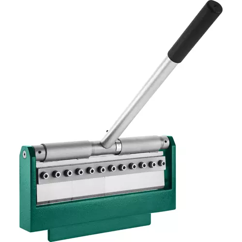

T10726 12" Vise-Mounted Pan and Box Brake
Use your bench vise to make precision bends on small sheet metal components.
The T10726 12" Vise-Mounted Pan and Box Brake is designed for small bending projects (such as boxes, pans, and trays) in sheet metal that is 22-gauge or thinner.
When secured in a sturdy bench-mounted vise, four fingers of different lengths can be arranged in a variety of combinations to make 90° bends of varying widths up to 12" wide.
The adjustable fingers also permit the sides of a box to be bent without interfering with previously bent sides.
Like all Grizzly pan and box brakes, the T10726 comes with a 1-year warranty which covers parts and assures the unit is free from factory defects.
The T10726 manual was written by our U.S. based Technical Documentation Department and is packed with useful information. The complete and easy-to-read manual makes it easier to assemble and maintain your pan and box brake.
The Grizzly Customer Service and Technical Support Teams are U.S. based. Parts for the pan and box brake may be available online and shipped from the Grizzly parts warehouse in Springfield, MO.
  • Maximum width: 12"
  • Maximum thickness at half width (mild steel): 18-gauge
  • Maximum thickness at full width (mild steel): 20-gauge
  • Bending angle: 0-90°
  • Number of fingers: 4
  • Finger sizes: 1", 2", 3", 6"
  • Approximate shipping weight: 22 lbs.
