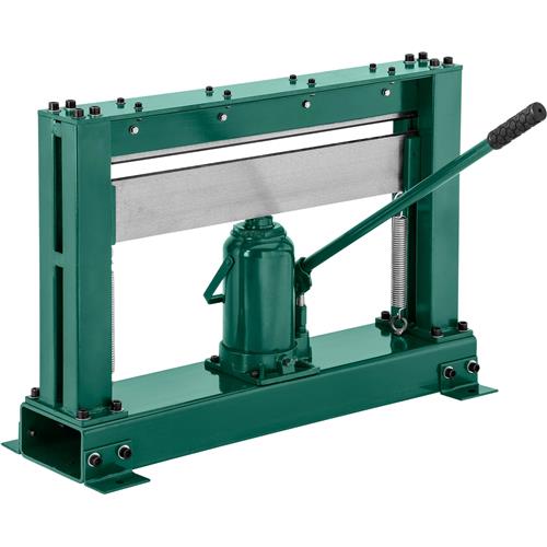

The usefulness of a compact, powerful bending brake cannot be overstated. The T28930 24" Hydraulic Bending Brake offers 20 tons of force for simple and accurate bending.
With a few pumps of the handle, the hydraulic arm extends the bending bar to bend sheet metal up to 14-gauge from 0-90°. Return springs bring the bending bar back to the starting point every time.

  • Maximum width: 24"
  • Maximum thickness at half width mild steel: 14-gauge
  • Maximum thickness at full width mild steel: 16-gauge
  • Aluminum: 12-gauge
  • Stainless steel: 18-gauge
  • Bending range: 0–90°
  • Hydraulic force: 20 Tons
  • Approximate shipping weight: 127 lbs.
  • 20 tons of hydraulic clamping power for easy operation
  • Bending range of 0°–90°
