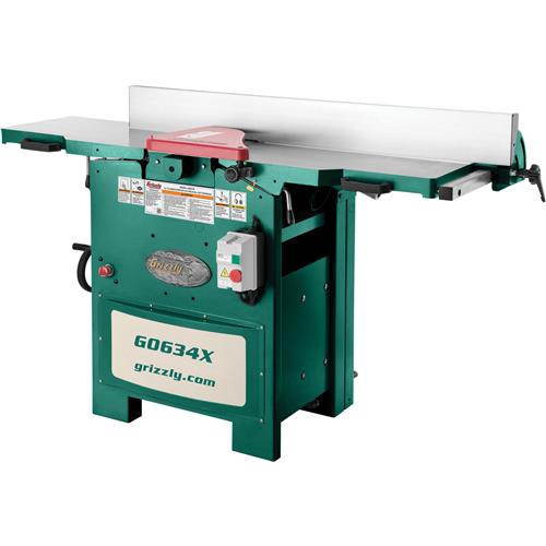

G0634X 12" 5 HP Planer/Jointer with V-Helical Cutterhead
Joint and plane all in one space-saving machine!
Most woodworking projects require lumber that is jointed and planed as a starting point. Save time, space, and money with a machine that does it all.
The G0634X 12" 5 HP Planer/Jointer combines a powerful 5 HP motor with a V-helical cutterhead for unmatched finish and long-lasting durability compared to a machine with straight knives.
No need to sharpen the blades every time they get dull or nicked. The 48 indexable carbide inserts can be rotated up to 3 times for a new sharp edge.
The quick-release, aluminum fence can be positioned at any angle between 45° and 90° as shown by the tilt scale. The fence has been end-mounted to save space so nothing is protruding from the back of the machine.
Conversion from the jointer to the planer is easy. Just remove the quick-release fence and flip up the jointer tables. To use the jointer again, simply release and lower the tables, put the fence back on and you are ready to face or edge joint.
The planer features cast-iron infeed and outfeed tables, two feed rollers, anti-kickback fingers, and a depth of cut scale on the front.
Ideal for anyone looking to start or expand a small pro shop.
  • Motor: 5 HP, 220V, single-phase, 25A
  • Maximum jointer cut width: 12"
  • Maximum jointer cut depth: 1/8"
  • Maximum planer cut width: 11-3/4"
  • Maximum planer stock thickness: 8"
  • Cutterhead diameter: 3-1/8"
  • Cutterhead speed: 5034 RPM
  • Cutterhead type: V-helical, 4-row, 48 inserts
  • Cutterhead insert size: 15 x 15 x 2.5mm
  • Planer table size: 12-1/4" x 23-1/8"
  • Planer feed rate: 22 FPM
  • Bevel jointing: 0°–45°
  • Jointer table size: 14" x 59-1/2"
  • Fence: 6" x 51-1/4", end-mounted
  • Fence stops: 45°, 90°
  • Dust port: 2 @ 4"
  • Footprint: 26" x 19-1/2"
  • Overall size: 67-1/2" W x 24" D x 41-1/2" H
  • Approximate shipping weight: 750 lbs.
  • Superior finish and improved dust collection from the V-helical cutterhead
  • End-mounted fence to save space allowing the machine to be put against a wall
  • Flip-up tables and change lever simplify jointer/planer conversion
  • Rubber-coated outfeed roller eliminates roller impressions on finished workpieces
