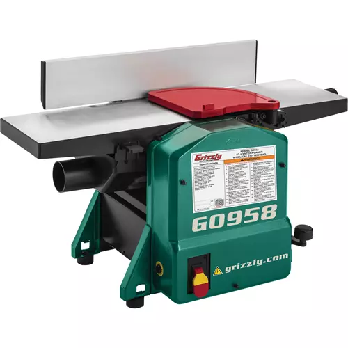

G0958 8" Combo Planer/Jointer
An 8" 2-in-1 planer jointer that maximizes valuable work space.
For woodworkers that lack the space for two benchtop machines, the G0958 8" Combo Planer/Jointer will simplify your shop.
The compact benchtop design fits in small shops and is easy to use by hobbyists and DIYers looking to clean up old or rough lumber.
The G0958 helical cutterhead has 18 inserts diagonally arranged in two rows for smooth shearing cuts, minimized tearout, a smoother finish, and operating at lower noise levels compared to straight knife blades. Each can be rotated up to three times to expose a new sharp edge.
The 1-1/2 HP motor provides plenty of power for planing or jointing. The dust collection shroud easily relocates depending on which operation you are using, while the 2" dust port allows easy connection to a dust collector.
The planer and jointer tables lock firmly in place when in use, allowing accurate, repeatable cuts.
Handymen and women will love the portability this machine provides when bringing it on a job site.
Don’t be fooled by competitors that sell similarly-priced machines with straight knives.
The H9893 replacement inserts are available when the stock inserts get dull.
The easy-to-read G0958 manual was written by our U.S.-based Technical Documentation Department and is packed with useful information. The complete and easy-to-read manual makes it easier to assemble and maintain your planer.
