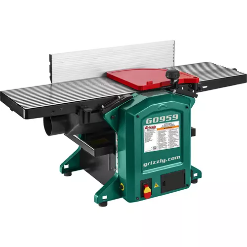

G0959 12" Combo Planer/Jointer with Helical Cutterhead
A 12" 2-in-1 planer jointer that maximizes valuable work space.
For woodworkers that lack the space for two benchtop machines, the G0959 12" Combo Planer/Jointer will simplify your shop.
The compact benchtop design fits in small shops and is easy to use by hobbyists and DIYers looking to clean up old or rough lumber.
The G0959 helical cutterhead has 28 inserts diagonally arranged in two rows for smooth shearing cuts, minimized tearout, a smoother finish, and operating at lower noise levels compared to straight knife blades. Each can be rotated up to three times to expose a new sharp edge.
The 1-1/2 HP motor provides plenty of power for planing or jointing. The dust collection shroud easily relocates depending on which operation you are using, while the 4" dust port allows easy connection to a dust collector.
The planer and jointer tables lock firmly in place when in use, allowing accurate, repeatable cuts.
Handymen and women will love the portability this machine provides when bringing it on a job site.
Don’t be fooled by competitors that sell similarly-priced machines with straight knives.
Like all Grizzly combination machines, the G0959 comes with a one-year warranty which covers parts and assures the unit is free from factory defects. (Consumables are not covered by the warranty.)
The easy-to-read G0959 manual was written by our U.S.-based Technical Documentation Department and is packed with useful information.
Parts for the planer/jointer may be available online and shipped from the Grizzly parts warehouse in Springfield, MO.
  • Motor: 1-1/2 HP, 120V, single-phase, 15A
  • Maximum cut width: 11-3/4"
  • Maximum cut depth: 3/64"
  • Minimum workpiece length: 6"
  • Minimum thickness: 1/4"
  • Cutterhead type: 2" helical with 2-row spirals, 28 inserts
  • Insert size and type: 15mm x 15mm x 2.5mm indexable carbide inserts
  • Cutterhead speed: 8500 RPM
  • Cuts per minute: 17,000
  • Planing feed rate: 22 FPM
  • Bevel jointing: 0–45°
  • Fence size: 25" L x 5" H
  • Planer table size: 19-3/4" L x 12" W
  • Jointer table size: 42-3/8" L x 12" W
  • Footprint: 19" x 15-1/2"
  • Overall dimensions: 45" W x 23-1/2" D x 22-1/2" H
  • Approximate shipping weight: 95 lbs.
  • Helical cutterhead with 28 indexable carbide inserts
  • Die-cast aluminum infeed and outfeed tables
  • Quick-release fence with stops at 0° and 45°
  • 4" Dust port
  • One push block and one push stick
  • Torx T-20 t-handle driver
