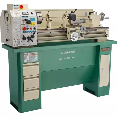

G0949G 12" x 35" Variable-Speed Gunsmith Lathe
A loaded gunsmith lathe at a competitive price.
The G0949G 12" x 35" Variable-Speed Gunsmith Lathe has a small footprint, but packs plenty of features not found on standard lathes.
The lathe is loaded with features not limited to only a gunsmith but anyone looking for a high-quality, affordable variable speed lathe.
The spider mount system has four brass-tipped screws that stabilize long shafting and rifle barrels through the outboard end of the spindle.
Supplied with a 1-1/2 motor, the 2-speed gearhead produces variable spindle speeds from 100–515 RPM and 390–2000RPM.
The G0949G also comes with a D1-4 spindle, a 200 series quick-change tool post, digital spindle speed readout, and a full-length splash guard.
Like all Grizzly gunsmith lathes, the G0949G comes with a 1-year warranty covering parts and assuring the unit is free from factory defects.
The G0949G manual was written by our U.S. based Documentation Department and is packed with useful information. The complete and easy-to-read manual makes it easier to assemble and maintain your lathe.
The Grizzly Technical Support team is U.S. based. Parts and accessories for the lathe are available online and shipped from the Grizzly parts warehouse in Springfield, MO.
