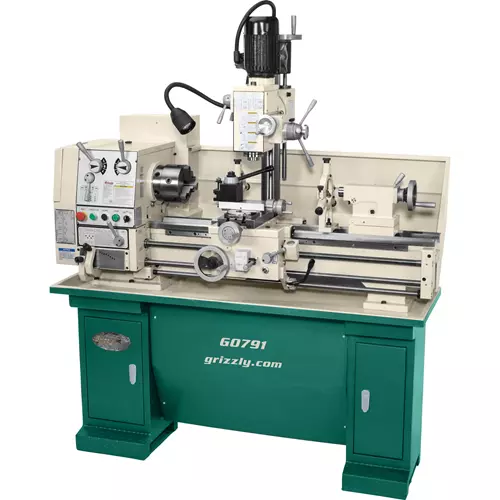

G0791 12" X 36" Combination Gunsmithing Lathe/Mill
The ultimate "small footprint" machining station for gunsmiths and machinists alike!
Don't let the compact size of the G0791 12" X 36" Combination Gunsmithing Lathe/Mill fool you, this combo lathe/mill really delivers on big machine features.
It comes fully equipped with work-holding and tool-holding equipment and accessories to get you started turning, drilling, milling, chambering, boring, and facing.
The spider mount system is especially designed for supporting long workpieces that extend through the outboard end of the spindle.
The tailstock lock system features a drive hub to ensure consistent draw-down alignment every time.
The 3/4 HP mill motor powers the R-8 spindle through four speeds ranging between 250–2300 RPM.
  • Lathe motor: 2 HP, 220V, single-phase, 8.5A
  • Mill motor: 3/4 HP, 220V, single-phase, 4.5A
  • Swing over bed: 12"
  • Distance between centers: 36"
  • Swing over saddle: 11-5/16"
  • Bed width: 7-1/4"
  • Lathe spindle bore: 1.57"
  • Lathe spindle taper: MT#5
  • Lathe spindle length: 17"
  • Lathe spindle length with 4-jaw chuck: 21-1/4"
  • Lathe speeds: 9, 70–1400 RPM
  • Tailstock taper: MT#3
  • Tailstock barrel travel: 4"
  • Cross slide travel: 6-1/4"
  • Compound travel: 3-1/4"
  • Maximum lathe tool bit size: 5/8"
  • Mill spindle taper: R-8
  • Mill spindle travel: 2-1/4"
  • Mill speeds: 4, 250–2300 RPM
  • Mill swing: 15"
  • Spindle to worktable: 12"
  • Mill table T-slots: 3/8", 2-7/16" OC
  • Range of threads (inches): 40 @ 4–112 TPI
  • Range of threads (metric): 29 @ 0.2–4.5mm
  • Footprint: 57-1/2" x 14-1/2"
  • Overall dimensions: 66" W x 27-1/2" D x 75" H
  • Approximate shipping weight: 1566 lb.
  • 1/2" Square drive in tailstock
  • Easy to use lever controls
  • Ball bearing steady/follow rests
  • Outboard spindle "spider" with 4 brass-tipped screws
  • Cast-iron stand with extended base
  • LED work light
  • Cuts LH threads
