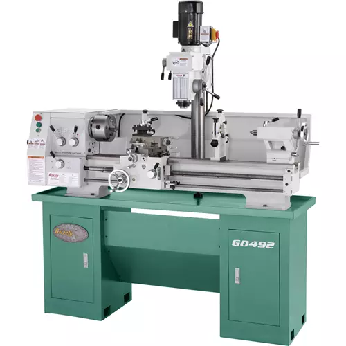

Image for Grizzly G0492 - 12" x 36" Metal Lathe w/ Milling Head
Whether you need to mill or turn, this fully featured machine can do it all for you! Both the mill and lathe have gear-head speed control. You can quickly flip levers to the needed spindle speeds for just about any combination of cutters and material. It features power cross and longitudinal lever control as well as an apron lock. Inch threading is also a snap with the thread chasing dial. The cross slide table has T-slots for mounting vises or clamping your work piece directly and the milling head has the extra advantage of tilting left or right up to 90°! This machine is supplied with all the standard equipment any hobbyist or machine shop could need.
Standard Equipment:
  • 6" 3-Jaw chuck
  • 8" 4-Jaw chuck
  • 8" face plate
  • Cross slide table
  • Follow rest
  • Drill chuck with arbor
  • MT#3 and MT#5 dead centers
  • 4-way turret tool post
  • Forward/Reverse switch with emergency stop
  • Lathe motor 1-1/2 HP, 220V, single-phase
  • Mill/drill motor 3/4 HP, 220V, single-phase
  • Lathe & Mill motor speeds 1725 RPM
  • Swing over bed 12-1/2"
  • Swing over saddle 7-1/4"
  • Distance between centers 36"
  • Lathe spindle bore 1-1/2"
  • Lathe spindle taper MT#5
  • Tailstock taper MT#3
  • Tailstock barrel travel 3"
  • Cross slide travel 6-1/4"
  • Compound travel 2-1/4"
  • Mill/drill spindle taper R-8
  • Draw bar size 7/16"-20 TPI
  • Mill/drill swing 14-1/2"
  • Lead screw pitch: 5 TPI
  • Maximum distance spindle to work table 17-1/4"
  • Mill head vertical travel 8"
  • Number of speeds 12 lathe / 4 mill/drill
  • Lathe speed range 75, 110, 140, 200, 240, 350, 420, 600, 720, 1050, 1250, 1900 RPM
  • Mill/drill speed range 240, 600, 1100, 2700 RPM
  • Range of threads (inches) 28 @ 5 - 48 TPI
  • Range of threads (metric) 21 @ 0.45 - 6.0mm
  • Approximate shipping weight 1200 lbs.
