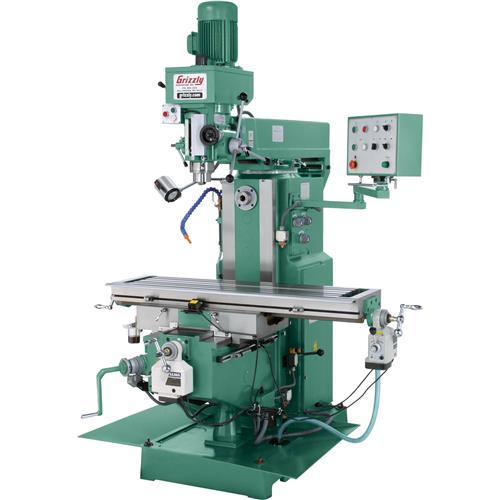

This machine has all the power, speed and versatility needed for the most demanding jobs. The massive castings that make up this machine will support huge loads and with 3 axis powered motion you'll be able to position your workpiece in short order and with little effort. When you're ready to cut, select speeds down to 108 RPM (vertical spindle) or 48 RPM (horizontal spindle) for those tough to machine alloys or for swinging those large diameter side mills. And both spindles are gear-heads so changing speeds is as easy as flipping a lever. Plus, a tapping feature is included for the vertical spindle! Set the control to "Tap", start the spindle and when the tap is finished the spindle reverses, automatically withdrawing the tap! Comes supplied with two 3 HP motors, 12-5/8" x 51-5/8" table and accessories.
Standard Equipment:
  • 5/8" drill chuck w/ arbor
  • R-8 to MT#3 adapter sleeve
  • R-8 to MT#2 adapter sleeve
  • 1" horizontal arbor w/ spacers
  • 1-1/4" horizontal arbor w/ spacers
  • 2 draw bars
  • 6" machine vise
  • Set of 13, R-8 collets sized 1/8" - 7/8" by 1/16"
  • Wrenches
Features:
  • Centralized control panel
  • Auxiliary forward/reverse/stop for vertical spindle
  • Jog button for horizontal spindle next to the speed change levers
  • 3 axis powerfeed (including the knee!)
  • Adjustable limit switches for all 3 axis
  • Power down feed on quill w/ 3 feed rates and adjustable auto-stop and return
  • Power tapping feature with auto-reverse
  • Vertical motor 3 HP, 220V, 3-phase, 8.9 Amps
  • Horizontal motor: 3 HP, 220V, 3-phase, 8.9 Amps
  • RPM (each motor) 1725
  • Power transfer: Gear drive
  • Spindle taper: R-8
  • Spindle travel: 4-7/8"
  • Table size: 12-5/8" x 51-5/8"
  • Table travel (longitudinal): 26-3/8"
  • Table travel (cross): 10-1/16"
  • Knee travel (vertical): 15-3/4"
  • Max. dist. spindle to column: 30-5/8"
  • Max. dist. spindle to table: 20-3/4"
  • Max. dist. horizontal spindle center to table: 18-1/2"
  • Turret or column swivel: 360°
  • T-slots: 3 on 2-1/2" centers, 1/2" stud
  • Vertical spindle speeds: 8
  • Range of speeds: 108, 192, 317, 468, 552, 828, 1356 and 2400 RPM
  • Horizontal spindle speeds: 12
  • Range of speeds: 48, 72, 96, 132, 180, 240, 324, 456, 612, 816, 1140, and 1560 RPM Horizontal spindle sizes: 1" & 1-1/4"
  • Overall height: 91-3/4"
  • Approximate shipping weight: 4719 lbs.
