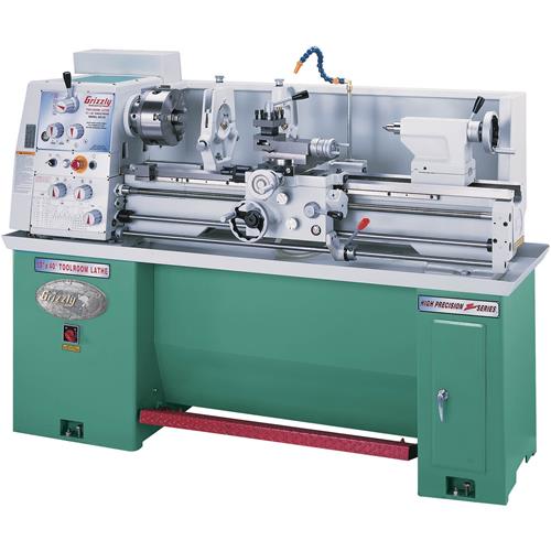

This is the best 13" Lathe we offer and is a dependable machine made for high precision work in a toolroom environment.
Features:
  • Precision ground V-bed is made of Meehanite casting
  • Headstock gears run in an oil bath and are hardened and precision ground for smooth, quiet and vibration free operation
  • Quick change gear box is fully enclosed and makes thread selection and engagement smooth and fast
  • Feed rod is equipped with an overload clutch for safety
  • Turret micrometer stop allows operator to set absolute stop to carriage for safety and close operations
  • Swing over bed: 13"
  • Swing over gap: 19-1/2"
  • Swing over cross slide: 7-1/2"
  • Distance between centers: 40"
  • Spindle size/type: D1-4 camlock
  • Spindle nose taper: MT #4
  • Spindle bore: 1-3/8"
  • Tailstock barrel taper: MT#4.5
  • Tailstock barrel travel: 4-3/8"
  • Cross slide travel: 7-1/2"
  • Top slide travel: 3-1/2"
  • Number of speeds: 8
  • Speed range: 105-2000 RPM
  • Range of threads (inches): 4-56 TPI
  • Range of threads (metric): 0.4-7 mm
  • Width of bed: 7-1/2"
  • Motor size (3 Phase): 3 H.P.
  • Shipping weight approximate: 1700 lbs.
Standard Equipment:
  • 7" 3-Jaw chuck
  • 8" 4-Jaw chuck
  • 10" face plate
  • Steady rest
  • Follow rest
  • Coolant system
  • Full length splash guard
  • Built-in stand
  • Dual inch/metric dials
  • Driving plate
  • Extra 8" D1-4 backplate
  • Centers, center sleeve, service tools, manual and toolbox
