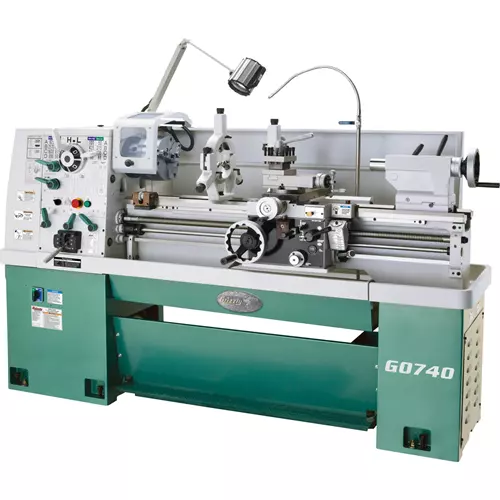

Grizzly G0740 - 14" x 40" 3-Phase High Precision Toolroom Metal Lathe
This full-featured 14" x 40" High-Precision Toolroom Lathe is equipped with just about everything needed to get a machine shop up and running—just add your own tooling! Hardened and precision-ground oil-bath lubricated gears and high quality spindle bearings are built to withstand heavy turning, yet hold tight tolerances for precision work. Cuts a wide range inch/metric threads and modular/diametral pitches. Features a hardened and precision-ground Meehanite-casting bedway, completely enclosed universal gearbox, complete coolant system, carriage feed stop, micrometer stop, 4-way toolpost, pull-out chip tray, safety foot brake, and one-shot way lubrication. Standard equipment includes 8" 3-jaw universal chuck, 10" 4-jaw independent chuck, 10" faceplate, ball bearing steady and follow rests, and dead centers.
