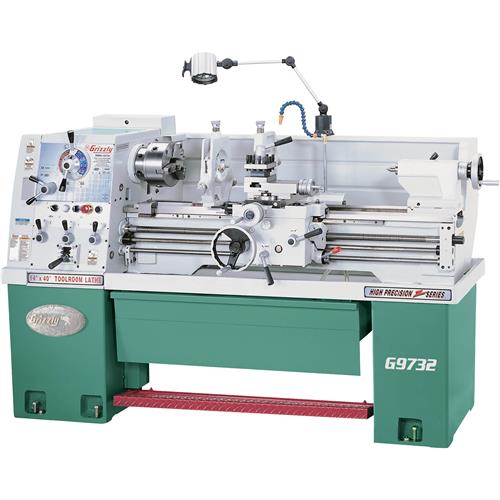

Image for Grizzly G9732 - 14" x 40" High Precision Tool Room Metal Lathe
Made for precision production work, this 14" ToolRoom Lathe can be put up against any fine quality lathe on the market today.
Features:
  • Precision ground V-bed is made of Meehanite casting
  • Totally enclosed universal gearbox allows cutting of Inch, Metric, Whitworth, Module and diametral threads
  • Headstock gears run in an oil bath and are hardened and precision ground for smooth, quiet, and vibration-free operation
  • Chip tray slides out for easy cleaning
  • Feed rod is equipped with an overload clutch for safety
  • Turret micrometer stop allows operator to set absolute stop to carriage for safety and close operations
  • Swing over bed: 14-1/4"
  • Swing over gap: 22"
  • Swing over cross slide: 8-5/8"
  • Distance between centers: 40"
  • Spindle size/type: D1-5 camlock
  • Spindle nose taper: MT #5
  • Spindle bore: 1-5/8"
  • Tailstock barrel taper: MT #3
  • Tailstock barrel travel: 5-3/4"
  • Cross slide travel: 7-3/4"
  • Top slide travel: 3-3/4"
  • Number of speeds: 16
  • Speed range: 35-2000 RPM
  • Range of threads (inches): 4-72 TPI
  • Range of threads (metric): 0.4-7 mm
  • Width of bed: 10"
  • Motor size (3 phase, 220V 2 speed): 5 H.P.
  • Shipping weight approximate: 2507 lbs.
Standard Equipment:
  • 8" 3-Jaw chuck
  • 10" 4-Jaw chuck
  • 12" face plate
  • Steady rest
  • Follow rest
  • Coolant system
  • Halogen light
  • Full length splash guard
  • Built-in stand
  • Dual inch/metric dials
  • Universal threading gearbox
  • Extra 8" D1-5 backplate
  • 5 H.P. 2 speed motor
  • Centers, center sleeve, service tools, manual and toolbox
