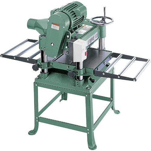

Features:
  • All ball bearing construction with powerful 2 H.P. single phase motor. Motor is 3450 RPM and draws 12 Amps at 220V
  • 4 heavy-duty support columns make vertical adjustment rigid and accurate
  • 3-knife cutterhead is ball bearing supported and powered by triple V-belts from the motor!
  • Includes jack screws and accessory spring kit
  • Comes complete with 3 HSS knives and 3-piece knife setting tool
  • Up/down calibrations are both inch and metric
  • Automatic infeed and outfeed rollers are chain driven and feed the work evenly for a smooth finish. Anti-kickback fingers prevent the board from backing up
  • Front power feed roller is metal and spiral serrated. Rear power feed roller is metal and minutely straight serrated
  • Table is cast iron and is precision ground to a mirror-like finish
  • Drive gears run in oil bath
  • Table measures 15" x 20"
  • Infeed and outfeed rollers extend 15" on each end of the table
  • Dual table locks prevent movement while planing
  • Magnetic switch is standard equipment and gives overload protection
  • Minimum thickness of board that can be fed is 1/4"
  • Maximum cutting width: 14-7/8"
  • Maximum cutting height: 6-1/8"
  • Maximum depth of cut: 1/8"
  • Rate of feed: 16 FPM and 20 FPM
  • Cutterhead speed: 5000 RPM
  • Number of knives: 3
  • Motor size: 2 H.P., 220V, single phase
  • FREE STAND
  • Shipping weight approx.: 440 lbs.
