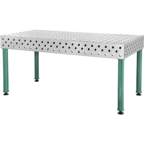

T30537 157" x 79" 3D Steel Welding Table Top
The ultimate welding table on the market.
The T30537 157" x 79" 3D Steel Welding Table Top has an extra-large, ultra-heavy-duty table surface.
Combined with 8" perpendicular sides, this solid steel table features machined surfaces for ultra-flat fixturing.
Like all Grizzly welding tables, the T30537 comes with a 1-year warranty which covers parts and assures the unit is free from factory defects.
The Grizzly Customer Service and Technical Support Teams are U.S. based. Parts and accessories for the welding table are available online and shipped from the Grizzly parts warehouse in Springfield, MO.
  • Capacity: 4400 lbs.
  • Hole diameter: 28mm
  • Grid spacing: 10 cm
  • Approximate shipping weight: 4960 lbs.
