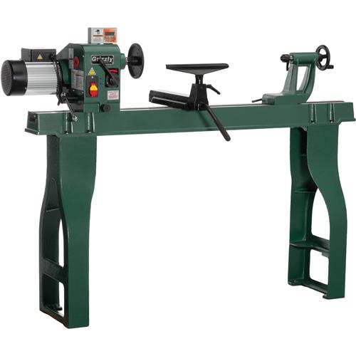

G0462 16" x 46" Wood Lathe with DRO
A deluxe turning machine at a very competitive price!
The G0462 16" x 46" Wood Lathe with DRO can swing 16" over the bed, comes with a 2 HP motor and sports a digital readout for spindle RPM.
Changing speeds is easy with the shift-on-the-fly speed control lever and there are no belts to mess with. The speed can be changed between 600 and 2400 RPM.
Outboard turning is a snap too, just loosen the headstock and swivel it up to 180° for total flexibility.
The solid cast-iron construction throughout ensures smooth and stable operation.
If you want to add more storage place, the legs feature shelf supports so you can add your own custom-built shelf.
If not required by any local codes, fastening the machine to the floor is an optional step. If you choose not to do this with your machine, we recommend placing it on mounts such as the G7159 Leveling Feet, as these provide an easy method for leveling and they have vibration-absorbing pads.
The G0462 manual was written by our U.S.-based Technical Documentation Department and is packed with useful information. The complete and easy-to-read manual provides full instructions on how to assemble and maintain your lathe.
  • Motor: 2 HP, 110V, single-phase, 14A
  • Swing over bed: 16"
  • Swing over tool rest: 12"
  • Distance between centers: 46"
  • Spindle taper: MT#2
  • Spindle thread size: 1" x 8 TPI RH
  • Tailstock taper: MT#2
  • Spindle speeds: Variable, 600-2400 RPM
  • Headstock rotation: 0°, 60°, 90°, 120°, and 180°
  • Tool rest width: 11-3/4"
  • Tool rest post length: 3"
  • Tool rest post height: 2-1/8"
  • Overall dimensions: 72-1/2" W x 19" D x 48"H
  • Approximate shipping weight: 354 lbs.
  • Digital readout for spindle RPM
  • 0°, 60°, 90°, 120°, and 180° headstock rotation
  • Quick lock/release levers for tailstock and headstock
  • Heavy-duty, precision-ground cast-iron bed and legs ensures stability and minimize vibration
  • 1-year limited warranty
