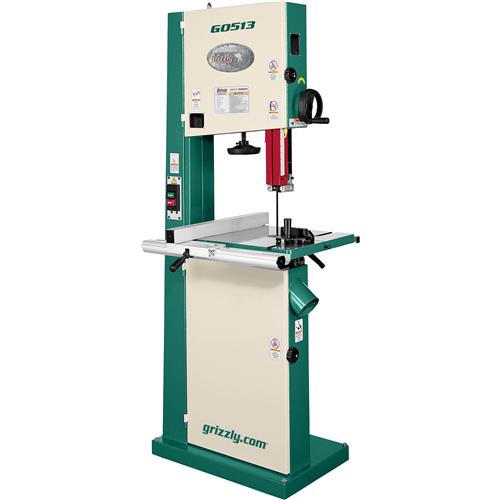

G0513 17" 2 HP Wood Bandsaw
A heavy-duty woodworking bandsaw with effective cutting capacity for DIY projects.
The fully-featured G0513 17" 2 HP Bandsaw allows for amazing sawing power in your garage or small shop.
The 2 HP motor powers through wood up to a maximum 12" cutting capacity and the 16-1/4" throat offers lots of room to move.
For a full range replacement and resaw blades for your G0513, click here.
Features including the deluxe fence, heavy-duty miter gauge, dual 4" dust ports, micro-adjusting geared table and European-style blade guides are usually found on machines costing much more.
The G0513 manual was written by our U.S.-based Technical Documentation Department and is packed with useful information. The complete and easy-to-read manual makes it easier to assemble and maintain your bandsaw.
CSA Certified
  • Motor: 2 HP, 110V/220V (prewired 220V), single-phase, 20A/10A
  • Cutting capacity: 16-1/4" left of blade
  • Resaw capacity: 12-1/8"
  • Blade size: 131-1/2" long
  • Blade width range: 1/8"–1" wide
  • Blade speeds: 1700, 3500 FPM
  • Table size: 17" x 17" x 1-1/2" thick
  • Table tilt: 10° left, 45° right
  • Floor to table height: 37-1/2"
  • Footprint: 27" W x 18" D
  • Overall dimensions: 32" W x 32" D x 73" H
  • Approximate shipping weight: 322 lbs.
  • Deluxe extruded-aluminum fence
  • Euro-style roller-disc blade guides with full enclosure protection
  • Sealed and permanently lubricated bearings
  • Two 4" dust ports
  • Quick-change blade release/tensioner
  • Blade tension indicator
  • Micro-adjusting geared table
  • Blade height measurement scale
  • Blade tracking window
  • Miter gauge
  • Includes 1/2" 6-TPI hook blade
  • 1-year limited warranty
Note: The G0513 does not come with a plug. The recommended plug type is L5-30 for 110V or 6-15 for 220V.
