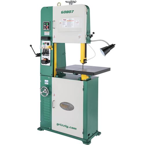

G0807 18" 2 HP Variable-Speed Vertical Metal-Cutting Bandsaw
A bandsaw that can meet the demands of today's busy metal shops!
The G0807 18" 2 HP Variable-Speed Vertical Metal-Cutting Bandsaw is ready handle all of your metal-cutting needs, even heavy production.
The extra-large table tilts side to side and front to back, allowing for the squarest cuts even with tight contour work.
Variable-speed blade control is available with just a turn of the handle, so you can handle even the toughest cutting jobs.
The built-in blade cutting and welding station with 1/8 HP grinder is easy to use, so you can make your own blades and save money!
The blade welding station also lets you create seamless inside cuts by cutting the blade and re-welding it inside your workpiece!
The durable cast-iron top end and platform provides a rock-solid, vibration-free table area that will last for years to come.

  • Main motor: 2 HP, 110V/220V (prewired for 220V) single-phase, 19A/9.5A
  • Grinder motor: 1/8 HP, 0.6A
  • Grinder wheel grit: #80
  • Throat (max. width left of blade): 17-9/16"
  • Maximum cutting height: 9-5/8"
  • Blade speed: 88–384 FPM
  • Blade length range: 139-3/8–140-1/2"
  • Blade width range: 1/8–5/8"
  • Blade welder thickness range: 0.025"
  • Blade welding power: 2.4 KVA
  • Table size: 22-1/8" x 19-7/8"
  • Table tilt: 15° left/right, 10° front/back
  • Floor to table height: 38-1/2"
  • Footprint: 16-1/2" x 34"
  • Overall dimensions: 40-1/2" W x 21-1/4" D x 73-1/2" H
  • Approximate shipping weight: 999 lbs.
  • Fully-balanced, 18-1/8" x 1-1/4" cast-iron wheels
  • Rubber-bonded wheels
  • Rack-and-pinion upper guide adjustment
  • Built-in blade welder and grinder
  • Annealing station
  • Hardened tungsten blade guides
  • Chip blower
  • Worklight
