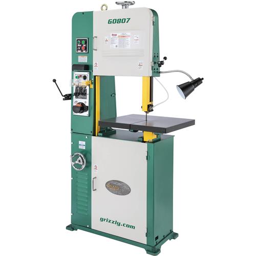

G0807 18" 2 HP Variable-Speed Vertical Metal-Cutting Bandsaw
A bandsaw that can meet the demands of today's busy metal shops!
The G0807 18" 2 HP Variable-Speed Vertical Metal-Cutting Bandsaw is ready handle all of your metal-cutting needs, even heavy production.
The extra-large table tilts side to side and front to back, allowing for the squarest cuts even with tight contour work.
Variable-speed blade control is available with just a turn of the handle, so you can handle even the toughest cutting jobs.
The built-in blade cutting and welding station with 1/8 HP grinder is easy to use, so you can make your own blades and save money!
The blade welding station also lets you create seamless inside cuts by cutting the blade and re-welding it inside your workpiece!
The durable cast-iron top end and platform provides a rock-solid, vibration-free table area that will last for years to come.
Limit switches on upper and lower wheel cover doors will not allow bandsaw to start if doors are open.
For a full range of replacement blades for the G0807, shop here.
Get durability with seamless metal cutting with this rock-solid bandsaw.
Like all Grizzly bandsaws, the G0807 comes with a 1-year warranty which covers parts and assures the unit is free from factory defects.
The G0807 manual was written by our U.S.-based Technical Documentation Department and is packed with useful information.
The Grizzly Customer Service and Technical Support Teams are U.S.-based. Parts and accessories for the bandsaw may be available online and shipped from the Grizzly parts warehouse in Springfield, MO.
  • Main motor: 2 HP, 110V/220V (prewired for 220V) single-phase, 19A/9.5A
  • Grinder motor: 1/8 HP, 0.6A
  • Grinder wheel grit: #80
  • Throat (max. width left of blade): 17-9/16"
  • Maximum cutting height: 9-5/8"
  • Blade speed: 88–384 FPM
  • Blade length range: 139-3/8–140-1/2"
  • Blade width range: 1/8–5/8"
  • Blade welder thickness range: 0.025"
  • Blade welding power: 2.4 KVA
  • Table size: 22-1/8" x 19-7/8"
  • Table tilt: 15° left/right, 10° front/back
  • Floor to table height: 38-1/2"
  • Footprint: 16-1/2" x 34"
  • Overall dimensions: 40-1/2" W x 21-1/4" D x 73-1/2" H
  • Approximate shipping weight: 999 lbs.
  • Fully-balanced, 18-1/8" x 1-1/4" cast-iron wheels
  • Rubber-bonded wheels
  • Rack-and-pinion upper guide adjustment
  • Built-in blade welder and grinder
  • Annealing station
  • Hardened tungsten blade guides
  • Chip blower
  • Worklight
* This machine is prewired for 220V operation. 110V operation requires purchase and installation of conversion kit P0807425.
