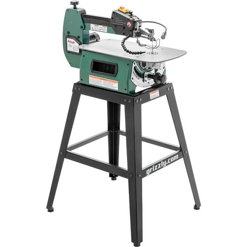

T34400 18" Variable-Speed Scroll Saw with Stand
Create precise, detailed designs on a stationary table with a saw that tilts.
The design of the T34400 keeps your workpiece level for greater functionality and accuracy on complex woodworking projects like custom signs, fretwork, inlays, and model-making.
The small variable-speed scroll saw blade delivers a smooth cut at up to 18" from the workpiece edge, and the large 22-1/2" x 12" table offers plenty of space for your creativity.
When lifted, the support arm locks in the raised position to provide clear access to blade mount assemblies for efficient blade changes. A pull on the quick-release pin to return the arm to the operating position has you back to scrolling in no time.
Variable-speed control gives you the flexibility you need to select just the right speed for your workpiece type. The cam-action blade release provides easy, tool-free blade changes so you can avoid extended delays.
A flexible air nozzle, work light, and dust collection port all work together to keep your cut line clear and visible as you work. The sturdy stand minimizes vibration, helping you maximize your efficiency.
This professional-quality scroll saw is an excellent choice for woodworkers and hobbyists looking to increase their expertise and produce unique finished pieces.
FEATURES & BENEFITS:
  • Tilting Head: The saw itself tilts, not the table, so you can make angled cuts while keeping your workpiece level and stable.
  • Large 22-1/2" x 12" Table: Extended-length table for large-scale projects.
  • 18" Depth of Cut: Get the exact cut you need for even sizeable workpieces.
  • Auto-Lock Support Arm: Keeps your material from shifting as the saw operates, and positive indexing holes at 0°, 22-1/2°, 30°, and 45° for precision cuts.
  • Variable-Speed Control: Dial in your cutting speed between 550–1550 SPM based on the hardness of your workpiece.
  • Quick-Release Blade Change: Cam-action blade release allows for fast and simple changes.
  • Flexible Air Nozzle, LED Work Light, and Dust Port: All three features combine to ensure continued visibility by keeping the cutting area clear of dust and chips.
  • Convenient Stand: A solid steel stand minimizes vibration during use.
  • Motor: 75W, 120V, single-phase, 1.3A
  • Depth of throat: 18"
  • Max. cut thickness: 2"
  • Max. cutting width: 18"
  • Blade size and type: 5", pin-end or plain-end
  • Blade stroke: 3/4"
  • Blade speed: Variable, 550–1550 SPM
  • Blade tilt angle: 30° L / 45° R
  • Table size: 12" x 22-1/2"
  • Dust port: 1-1/2"
  • Footprint: 26-1/2" x 23-1/2"
  • Overall dimensions: 23-1/2" W x 30" D x 47" H
  • Approximate shipping weight: 76 lbs.
Reduce time on challenging interior workpiece cuts with the T34400 18" Variable-Speed Scroll Saw!
