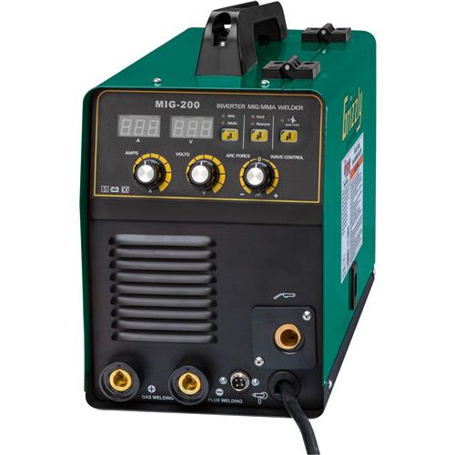

G0882 200A MIG Welder
The ultimate easy-to-use industrial welder with power to spare.
This G0882 200A MIG Welder allows you to quickly dial-in amperage, voltage, and arc force for better low-voltage electrode control when stick welding. You’ll have perfect wave control of the weld resulting in the perfect weld bead.
The built-in Insulated Gate Bipolar Transistor (IGBT) inverter improves efficiency from the power source, which is clearly displayed on the machines digital readout and mean as voltage control adjustment on-the-fly for simple weld puddle control. It operates on both standard 120V and 230V power sources, making it a great option for any home or shop.
The G0882 is capable of both MIG welding and stick welding up to 200A with a maximum material thickness of up to 3/8"! Simply spool-up the machine with your choice of .030” or .035” wire, connect the gas line to the machine and ground clamp to your work area, dial-in your settings, and you’re ready to lay down some smooth, even welds. Add a convenient roll-around welding cart to create a perfect shop ready wielding unit.
ETL certified
  • Input power: 120V/230V, single-phase, 20A/50A
  • Output current range (120V): 30–100 Amps
  • Output current range (230V): 30–200 Amps
  • Voltage output range: 15.5–24 Volts
  • Duty Cycle (120V): 35% @ 100 Amps
  • Duty Cycle (230V): 25% @ 200 Amps
  • Max material thickness: 3/8"
  • Wire diameter: 0.030" & 0.035"
  • Wire feed speed range: 80–600 IPM
  • Wire spool diameter range: 4–8"
  • Protection Class: IP21S
  • Overall dimensions: 9" W x 18 "D x 15" H
  • Approximate shipping weight: 40 lbs.
  • IGBT technology improves efficiency
  • Adjustable amperage and voltage control with digital display
  • Arc force and wave control
  • Gas test button
  • Quick wire feed button
  • Capable of welding steel, stainless steel, and carbon steel
Need help? We offer U.S.-based customer service and technical support to get your questions answered and help keep your equipment running in top condition. And to ensure your satisfaction, the G0882 comes with a 1-year warranty.
