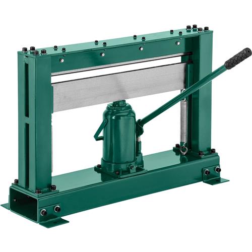

The usefulness of a compact, powerful bending brake cannot be overstated. The T28930 24" Hydraulic Bending Brake offers 20 tons of force for simple and accurate bending.
With a few pumps of the handle, the hydraulic arm extends the bending bar to bend sheet metal up to 14-gauge from 0-90°. Return springs bring the bending bar back to the starting point every time.
Like all Grizzly machines, the T28930 comes with a 1-year warranty which covers parts and assures the unit is free from factory defects.
The T28930 manual was written by our U.S. based Technical Documentation Department and is packed with useful information.
The Grizzly Customer Service and Technical Support Teams are U.S. based. Parts and accessories for the bending brake may be available online and shipped from the Grizzly parts warehouse in Springfield, MO.
  • Maximum width: 24"
  • Maximum thickness at half width mild steel: 14-gauge
  • Maximum thickness at full width mild steel: 16-gauge
  • Aluminum: 12-gauge
  • Stainless steel: 18-gauge
  • Bending range: 0–90°
  • Hydraulic force: 20 Tons
  • Approximate shipping weight: 127 lbs.
  • 20 tons of hydraulic clamping power for easy operation
  • Bending range of 0°–90°
