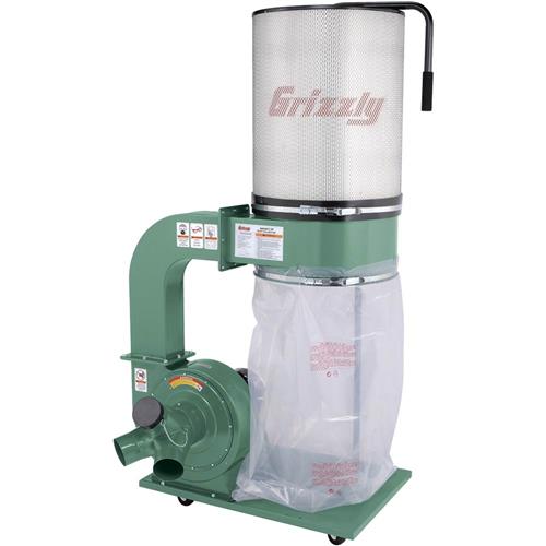

With a filter rating of 1-micron, the canister filter on this 2HP Dust Collector has 6 times the filtering area of a regular bag filter. Inside the filter is a cleaning device that can be easily operated from outside to remove caked-on dust. With a couple of quick turns of the handle, a well-used machine can be brought nearly back to full-performance capacity. An included heavy-duty steel adapter allows three 4" lines to be connected simultaneously. The steel duct from the impeller to the filter improves performance and reliability, and with just a glance, you'll know when it's time to haul out the chips—thanks to the clear bottom bag. Extra bags are also included and we sell replacements to really make cleaning easy.
CSA certified meeting CSA C22.2 #243-M91 and UL 1017-4th standards!
FEATURES
  • With the canister filter, simply turn the handle on the top a half turn in either direction to clean the canister
  • The handle controls three cleaning flappers inside and shakes the dust from the filter letting the fine dust fall directly into the collection bag
  • The canister filter is made of spun bond polyester with 1 micron filter capacity
  • Clear plastic collection bag with quick clamp
  • Extra bottom bags included
    SPECIFICATIONS
  • Motor: 2 HP, 240V, single-phase
  • Blower/impeller: 12-3/4" aluminum
  • Air suction capacity: 1700 CFM
  • Static pressure: 10"
  • Sound rating: 74 dB
  • 6" inlet has removable "Y" fitting with three 4" inlets
  • Canister filter size (dia. x depth): 19-5/8" x 23-5/8"
  • Bag capacity: 5.7 cubic feet
  • Overall dimensions: 31-1/2"W x 37-3/8"L x 71"H
  • Approximate shipping weight: 155 lbs.
    Optional replacement items: H5783-Upper Canister, T20543-Lower Bag
