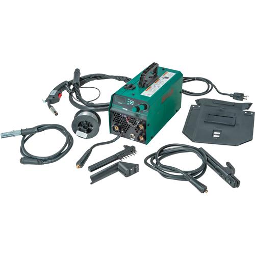

T34311 3-in-1 Welder MIG, MMA, TIG
Fine-tune your welding skills and complete quality projects with this multi-functional welder.
This welder can perform MIG (gasless), TIG, and stick welding with equal efficiency, and is an ideal choice for someone just getting started in the field.
This 3-in-1 welder offers IGBT technology, a stable current, and a 120V inverter to guarantee efficiency every time you arc up.
Execute precise welds on various metals and alloys for auto body modifications, household repairs, and general fabrication tasks with this adaptable machine.
Features and Benefits:
  • Versatile Operation: Complete stick (MMA), MIG (gasless), and TIG welding based on your material type and preferences.
  • IGBT Technology: Enhances reliability and energy efficiency and gives precise control during the welding process.
  • Current Efficiency: Offers a stable current and efficient arc start during MIG welding, and simple voltage and current adjustment for all welding types.
  • 120V Inverter: Improves efficiency from the power source for better welder performance.
  • Workpiece Types: Use with carbon steel, nickel, copper, and their alloys. Suitable for plate thickness of more than 0.8mm, middle and thin plate welding.
  • Portability: Transport this lightweight welder easily from location to location.
  • Required power source: 110V, single-phase, min. 20A circuit
  • Output current range (MMA): 20-100A
  • Output current range (MIG): 20-120A
  • Output current range (TIG): 20-120A
  • Voltage output range: 10-24V
  • Duty Cycle (MMA): 30% @ 120A
  • Duty Cycle (MIG): 60% @ 90A
  • Duty Cycle (TIG): 100% @ 80A
  • Max material thickness: 1/4"
  • Wire diameter: 0.030 - 0.039 in.
  • Wire feed speed range: 4-1/2 - 44-1/2 IPM
  • Min. wire spool diameter: 21-1/2"
  • Protection Class: IP21S
  • Overall dimensions: 15" x 11" x 13"
  • Approximate shipping weight: 13 lbs.
Get started in welding and purchase the T34311 3-in-1 Welder MIG, MMA, TIG today!
This versatile machine is a perfect option that provides power, durability, and portability for anyone looking for an entry-level welder.
Grizzly documentation is produced by our U.S.-based team. Parts may be available online and are shipped from the Grizzly parts warehouse in Springfield, MO.
We offer U.S.-based customer service and technical support and to ensure your satisfaction, the T34311 comes with a 1-year warranty.
