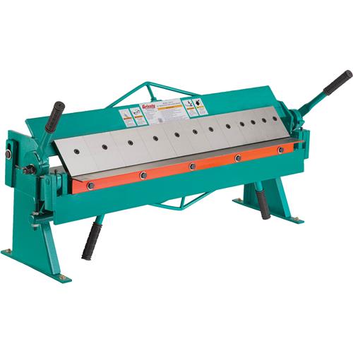

T32719 36" Benchtop Pan and Box Brake
Bend metal like a professional or at least pretend to.
The T32719 36" Benchtop Pan and Box Brake was designed to make complicated brackets, gussets, boxes or fixtures.
It can handle setting an angle in 18-gauge mild steel up to 135°.
The T32719 comes with twelve removable fingers for box forming and other special bending operations. The fingers can be used individually or all at once.
Like all Grizzly pan and box brakes, the T32719 comes with a 1-year warranty which covers parts and assures the unit is free from factory defects.
The T32719 instructions were written by our U.S. based Technical Documentation Department and is packed with useful information.
Parts and accessories for the brake are available online and shipped from the Grizzly parts warehouse in Springfield, MO.
SPECIFICATIONS
  • Maximum working width: 36"
  • Maximum half width sheet metal thickness: 16-gauge
  • Maximum full width sheet metal thickness: 18-gauge
  • Aluminum: 16-gauge
  • Stainless steel: 20-gauge
  • Brake range: 0–135°
  • Minimum reverse bend: 5/16"
  • Maximum height of pan/box brake sides: 2"
  • Fingers: (12), 2", 3", 4"
  • Footprint: 40-1/2" x 13"
  • Overall dimensions: 47-1/2" W x 20" D x 24" H
  • Approximate shipping weight: 226 lbs.
  • Precision-ground steel fingers with hardened edges
  • Twelve adjustable/removable fingers
