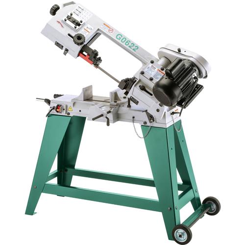

Grizzly G0622 - 4" x 6" 3/4 HP Metal-Cutting Bandsaw
G0622 4" x 6" 3/4 HP Metal-Cutting Bandsaw
A great mobile bandsaw for small shops and workspaces.
The G0622 4" x 6" 3/4 HP Metal-Cutting Bandsaw was designed to cut 4-1/2" round and 4-1/2" x 6 rectangular metal stock. It can cut in either horizontal or vertical positions.
The 64-1/2" x 1/2" blade rotates at one of the three blade speeds (78, 108 and 180 FPM). Blade speed adjustments are as easy as moving the location of the V-belt on the motor and wheel pulleys.
The feed rate is also adjustable by rotating the feed rate handle. For optimal cutting and blade life, you will want to watch the chips that exit the cut and increase or decrease the feed rate according to chip characteristics.
Additional features include handles and wheels for portability and an automatic shutoff for added safety.
Like all Grizzly bandsaws, the G0622 comes with a 1-year warranty which covers parts and assures the unit is free from factory defects. (Consumables are not covered by the warranty.)
The G0622 manual was written by our U.S. based Technical Documentation Department and is packed with useful information. The complete and easy-to-read manual provides full instructions on how to assemble and maintain your metal-cutting bandsaw.
The Grizzly Customer Service and Technical Support Teams are U.S. based. Parts and accessories for the bandsaw are available online and shipped from the Grizzly parts warehouse in Springfield, MO.
  • Motor: 3/4 HP, 110V, single-phase, 5A
  • Max. capacity circular: 4-1/2" dia.
  • Max. capacity rectangular: 4-1/2" x 6"
  • Blade speeds: 78, 108, 180 FPM
  • Included Blade size: 64-1/2" x 1/2" x 14 TPI
  • Approx. shipping weight. 127 lbs.
  • Blade included
  • Automatic shutoff
  • Three cutting speeds
  • Ball bearing construction
  • Vertical cutting attachment
  • Handles and wheels for portability
