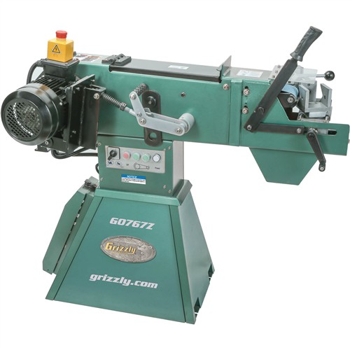

G0767Z 4" x 79" 3-Phase Abrasive Tube Notcher
The perfect notcher for any professional or production welding shop.
The G0767Z Abrasive Tube Notcher is designed to quickly notch or cope the ends of metal tubing, so two pieces of tubing can be welded together with clean, strong joints.
It is an ideal machine for production work in shops with three-phase power.
Quickly manufacture fencing, gates, roll cages, bicycle frames, stainless steel piping, or any other type of tubing work that requires joining multiple pieces together.
The vise allows the tube to be set at any angle from 30° to 90° to the grinding belt.
Using the variety of included profile rollers, notches can be formed in diameters from 3/4" to 3" and stored on the rack away from debris and grime.
After notching is complete, tubing edges can be deburred using an exposed flat section of the grinding belt. A full range of replacement belts are available.
Like all Grizzly Notchers, the G0767Z comes with a 1-year warranty covering parts and assuring the unit is free from factory defects. (Consumables are not covered by the warranty.)
The G0767Z manual was written by our U.S.-based Documentation Department and is packed with useful information. The complete and easy-to-read manual makes it easier to assemble and maintain your notcher.
The Grizzly Technical Support team is also U.S.-based. Parts and accessories for the notcher may be available online and shipped from the Grizzly parts warehouse in Springfield, MO.
  • Motor: 3 HP/4 HP, 220V, 3-phase, 9.7A/11.6A
  • Tube angle adjustment: 0°-30°
  • Sanding belt size: 4" x 78-3/4"
  • Sanding belt speed: 3580, 6180 FPM
  • Roller sizes: 3/4", 1", 1-1/4", 1-1/2", 2", 2-1/2", and 3"
  • Platen size: 4-1/2" x 15-3/8"
  • Footprint: 25-1/2" L x 16" W
  • Overall size: 31-1/2"W x 47-1/4"H x 49-1/4"L
  • Approximate shipping weight: 381 lb.
  • Ratcheting system for easy tensioning of sanding belt
  • Front debris-catching tray
  • 3" dust port
  • Easy belt alignment/tracking system
  • Top and rear sanding-belt access for deburring
  • Self-aligning vise with side-to-side adjustment to prevent uneven belt wear
  • Vise rotates 0–60 degrees
  • Transparent safety guard
  • Removable spark tray
