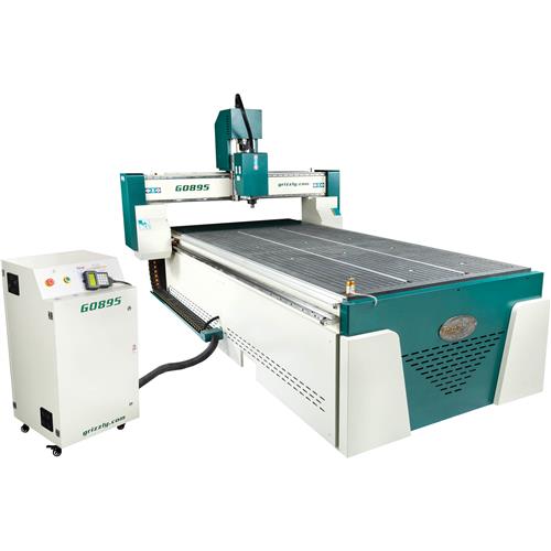

The full-sized G0895 4' x 8' CNC router has the capacity to fit a full 4' x 8' sheet of plywood and has ample spindle clearance for those thicker workpieces such as live edge slabs.
The massive work area features a 6-zone vacuum table with a 10 HP pump to secure workpieces.
Between the 6 HP, 18,000 RPM spindle, and the AC servo-controlled X- and Y- axes that approach rapid speeds of 1,600 inches per minute, this router is ready to quickly remove material.
The ER32 collet system allows for a wide array of tooling options and the included tool setter makes it simple to set them up.
An air-cooled spindle and automatic oiler system mean no extra hassle with cooling systems or maintenance schedules.
The integrated, hand-held controller allows you to store programs to its hard drive or load programs from a flash drive. It can even connect directly to you PC for file transfer and/or controller software updates.

- Required power source: 220V, 3-phase, min. 30A circuit
- Spindle motor: 6 HP, 220V
- X-, Y- and Z-axis motors: AC Servo, 7.1A
- Cutting area: 51" x 98-1/2"
- Z-axis travel: 11"
- X- and Y- travel Speed: 1500 IPM
- Z- travel speed: 400 IPM
- Spindle speed: 0-18000 RPM
- Collet Size: 1/4", 1/2"
- Collet Type: ER32
- Footprint: 122-1/2" L x 56-1/2" W
- Overall dimensions: 85" W x 124" D x 72" H
- Approximate shipping weight: 2535 lbs.
- Variable frequency drive (VFD) for smooth, high-torque variable speed using single-phase power
- Yaskawa 850W Servo Motor
- Taiwan HIWIN linear guide
- German WHM rack
- 10 HP Vacuum Pump
- 6-Zone vacuum table
