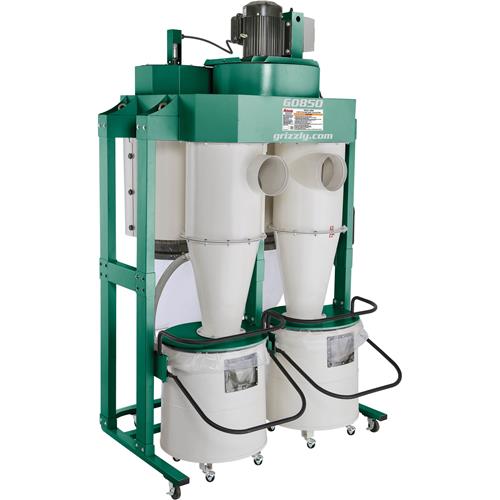

This impressive dust collector is so fully-loaded with features that the President of Grizzly Industrial special-requested one for his own shop. Sporting dual cyclone chambers and tandem 0.2-2 micron pleated filters with built-in automatic filter cleaning brushed, the G0850 is the ultimate in two stage dust separation. We thought of everything with this collector, from the heavy-duty, gusseted steel cage frame with caster wheels, to the quick-connect and locking latch handles for each of the 45-gallon collection drums. Each rolling collection drum features a thick gasket for an air-tight seal, ensuring material brought in via the 8" dust ports stays in place, and you'll know when it's time to empty the drum thanks to the extra large viewing window. With a massive 2,577 CFM of airflow capacity and 5 HP motor, the G0850 has all the power you need to operate up to 4 machines at once, all with the push of a convenient remote control. You can rest assured knowing that if the President of Grizzly Industrial requested this specific collector for his personal shop, that it's a tried and true workhorse.

  • Steel collection drum with casters for easy dust disposal
  • Dual-pleated cartridge filter with automatic cleaning motor for maximum filter efficiency
  • Clear disposal plastic collection bag
  • Remote-control
