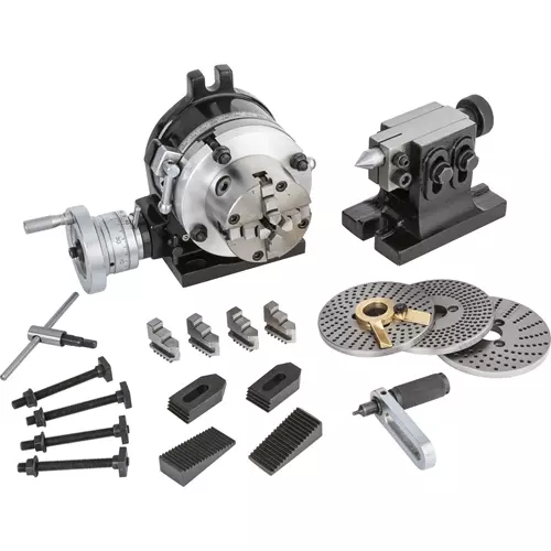

T25937 5" Rotary Table
Everything you need in one great rotary table set.
A rotary table allows drilling or cutting at exact intervals around vertical and horizontal axes.
The T25937 5" Rotary Table can be used in either the horizontal or vertical position for a variety of milling applications.
These different operations include milling eccentric features, cutting arcs, create large diameter holes, and circular profiles.
It includes a 3-1/4" 4-jaw scroll chuck with reversible jaws, set of dividing plates, and adjustable tailstock.
With 4° table movement per handle rotation and 20 second vernier scale, control is very precise.
The T25937 also includes a clamping set for the 4-slot table with 3/8" T-slots. Mounting slots are 9/16".

  • Worm gear ratio: 90:1
  • Table diameter: 4.88"
  • Table height: 3.93"
  • Base dimensions: 5" W x 7" L
  • Vertical base holes: 1/2" @ 3-1/2" on centers
  • Center sleeve: MT#2
  • Weight: 35 lbs.
  • Can be used in horizontal or vertical position
  • 4° movement per handle rotation
  • 20 second vernier scale
