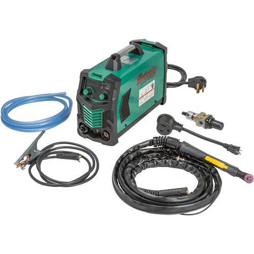

T34312 50A Plasma Cutter
Power through thick metal workpieces with this versatile dual-voltage plasma cutter.
This compact plasma cutter is perfect for DIYers, hobbyists, and fabricators looking for a portable machine that can easily cut steel up to 3/8" thick.
With dual voltage and adjustable amps, this portable plasma cutter works equally well at home and on-the-job.
The machine's high-frequency start makes it easy to execute precision welding with various material types.
Take advantage of additional features such as a digital AC display, an air and water separator, and a pressure regulator to complete metal fabrication, automotive repair, and specialty projects.
Features and Benefits:
  • Dual Voltage: Versatile for use in home workshops or at industrial sites with 110V and 220V power options.
  • Adjustable Amps: Includes a user-friendly dial for modifying amps between 20 and 50.
  • High Frequency Start: Minimizes wear on the electrode and workpiece and improves welding efficiency.
  • Cutting Capacity: Smoothly cut through up to 3/8” thick steel, stainless steel, aluminum, brass, and copper with exceptional precision.
  • Digital Display: Clearly shows the AC output current level for easy monitoring.
  • Air/Water Separator: Removes harmful moisture in the compressed air system to prevent equipment corrosion.
  • Pressure Regulator: Dial in the precise air flow you need for each welding project.
Includes:
  • 15' SG55-AG60 cutting torch
  • Nozzles, electrodes, shield cups (2 each)
  • Grounding cord
  • Power requirement: 110V or 220V, single-phase, 60 Hz
  • Min. circuit size: 50A
  • Output current range: 20-50A
  • Output voltage range: 88-100V
  • Duty cycle (110V): 40% @ 50A
  • Duty cycle (220V): 60% @ 50A
  • Max. material thickness: 3/8"
  • Torch cable length: 156"
  • Ground cable length: 60"
  • Air requirement: 72-1/2 PSI
  • Protection class: IP21S
  • Overall dimensions: 6" x 14-½" x 11-1/2"
  • Approximate shipping weight: 19 lbs.
Streamline your metal-cutting processes – add the T34312 50A Plasma Cutter to your shop today!
