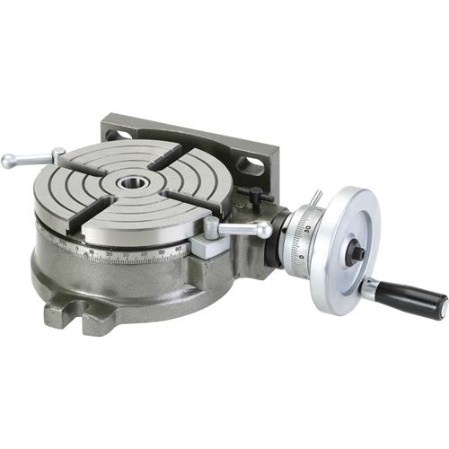

H7527 6" Horizontal/Vertical Rotary Table with Dividing Plates
A rotary table allows drilling or cutting at exact intervals around vertical and horizontal axes.
The H7527 6" Rotary Table can be used in either the horizontal or vertical position for a variety of milling applications.
With the set of dividing plates and adjustable tailstock, your milling applications are nearly unlimited.
These different operations include milling eccentric features, cutting arcs, create large diameter holes, and circular profiles.
Control is very accurate and precise thanks to the 4° table movement per handle rotation and 20 second vernier scale.
Also includes a 3/8" clamping set for the 4-slot table. Everything you need is in one great set!
Like all Grizzly rotary tables, the H7527 comes with a 1-year warranty which covers parts and assures the unit is free from factory defects.
The H7527 manual was written by our U.S.-based Technical Documentation Department and is packed with useful information. The complete and easy-to-read manual makes it easier to assemble and maintain your rotary table.
The Grizzly Customer Service and Technical Support Teams are U.S.-based. Parts for the rotary table may be available online and shipped from the Grizzly parts warehouse in Springfield, MO.
  • Worm gear ratio: 90:1
  • Table diameter: 5.91"
  • Table height: 3.11"
  • Base dimensions: W 8" x D 5.85"
  • Vertical base holes: 1/2" @ 4-1/2" on centers
  • Center sleeve: MT#2
  • Weight: 26 lbs.
  • Can be used in horizontal or vertical position
  • 4° movement per handle rotation
  • 20 second vernier scale
