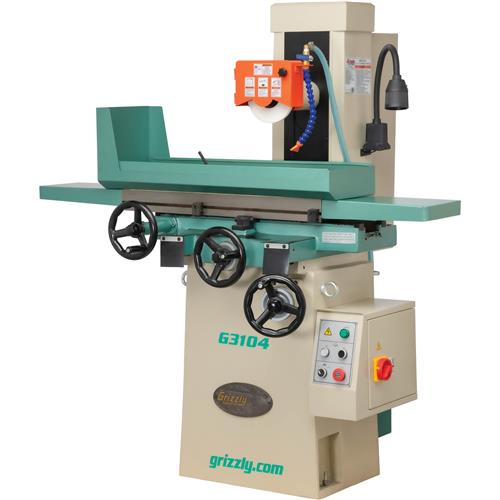

G3104 6" x 18" Surface Grinder
An excellent surface grinder for grinding precision parts in hardened or annealed ferrous metals.
The G3104 6" x 18" Surface Grinder features heavy cast-iron construction, quiet-running precision spindle, ball bearing longitudinal slide, coolant system and more.
Choose from our selection of grinding wheels then accurately true and balance them with the supplied kit.
This grinding machine is a must-have for precise, close tolerance work.
  • Motor: 2 HP, 110V/220V (prewired 110V), single-phase, 18.8A/9.4A
  • Table surface: 6" x 18"
  • Longitudinal travel: 20-1/2"
  • Cross travel: 6-7/8"
  • Maximum distance table to wheel: 10-3/4"
  • T-slot and size: 1/2" stud, 7/8" head
  • Grinding wheel: 7" Dia. x 1-1/4" Bore x 3/4" Wide
  • Column size: 7-1/2" x 12"
  • Spindle diameter: 1-1/4"
  • Spindle speed: 3450 RPM
  • Overall dimensions: 61" W x 42-3/4" D x 63" H
  • Approximate shipping weight: 1429 lbs.
  • 24-Grit grinding wheel
  • Grinding wheel balancing kit
  • Flood coolant system
  • Column dial
  • Cross feed dial
  • Cast-iron cabinet
  • One-shot lubrication
  • Work light
  • 5-7/8" x 15-3/4" magnetic chuck
  • Cast-iron construction
  • Splash guard
We offer U.S.-based customer service and technical support to get your questions answered and help keep your equipment running in top condition. And to ensure your satisfaction, the G3104 comes with a 1-year warranty.
This machine is prewired for 110V operation. 220V operation requires purchase and installation of P3104115X Overload Relay.
