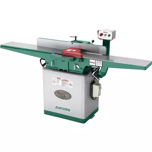

Item: G0586 | Model: G0586
Image for G0586
check out these great features and you will know why we are so excited about it!
  • Motor: 2 HP, 110V/220V, single-phase, Magnetic switch is 220V only, TEFC, 3450 RPM
  • 24/12A
  • Precision-ground cast iron table
  • Cutterhead knives: 4 HSS 8" x 3/4" x 1/8"
  • Cutterhead speed: 5500 RPM
  • Cutterhead diameter: 3-1/16"
  • Max. depth of cut: 1/8"
  • Max. rabbeting depth: 1/2"
  • Cuts per minute: 22,000
  • Deluxe cast iron fence size: 38"L x 1-1/4"W x 4"H
  • Approx. shipping weight: 480 lbs
    Features:
    • 9-1/4" x 75" precision ground cast iron bed - the longest on the market
    • Beds slide on dovetailed ways
    • Shielded & lubricated bearings
    • Double V-belt drive
    • Handwheel adjusted tables
    • Heavy-duty center mounted fence
    • Built-in dust chute
    • Powder coated paint
  • View More Details
